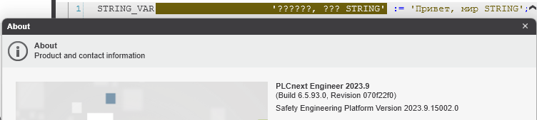

I would like to attract your attention to the issue of String datatype with Cyrillic content. It converts to “?” sign in case of static binding.
изображение.pngOr abracadabra of ASCII symbols when try to change value of variable dynamically.
Same code line in IDE 2023.9
изображение.pngOperates as expected.

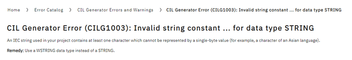

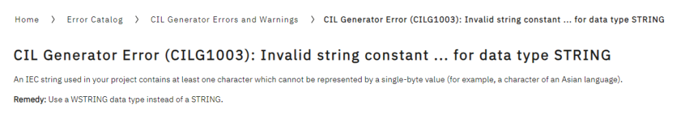

I will pass on these observations about the inconsistencies in the entry and display of Cyrillic characters in PLCnext Engineer (and in different versions of Engineer), however please be aware that the STRING type is explicitly designed so that “Each character is represented by one byte.”
Elementary Data Types according to IEC 61131-3 ');\n mywindow.document.close(); \n mywindow.focus();\n setTimeout(function () {\n mywindow.print();\n mywindow.close();\n }, 1000)\n return true;\n}\r\n\r\n\r\n Since it’s not possible to represent a Cyrillic character as a single byte (using ANSI encoding), you shouldn’t rely on multiple bytes in a STRING being interpreted in UTF format. The fact that this appears to be the case in some circumstances should be considered an anomaly, and not considered “correct” behaviour.
In cases where a string must be interpreted in UTF format, a WSTRING should be used. If there is a function block that does not support WSTRING variables, then please request this using the “Contact Developer” button on the product page in the PLCnext Store.

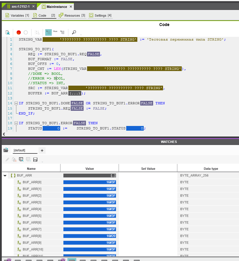

Is it simply a display issue? That is, does the STRING variable in PLCnext Engineer contain the same sequence of bytes in both cases (2023.9 and 2024.0)?
No, that is not just display issue (as if we try to display dynamic string variable to HMI).
PLC value of variable became unreadable ‘???’ and could not be processed in case of Cyrillic symbols.
And yes, for IDE 2023.9 and 2024 there is screenshots of the same value binding.

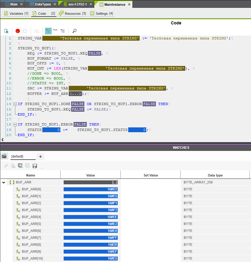

My question is:
In PLCnext Engineer version 2023.9, after this assignment:
image.png… if you then put STRING_VAR into a STRING_TO_BUF function block instance, what are the resulting values of bytes 0, 1, 2, etc. in the output buffer?
Then, in PLCnext Engineer version 2024.0, after this assignment:
If the bytes have the same value in both versions, then it’s a display issue. If the bytes have different values in both versions, then there is a deeper problem.
Sorry for misunderstanding.
Here screenshot of IDE2023-9 program version
And here screenshot of IDE2024-LTS
As you can see, buffer values are different.
Also, please find sample programs attached.
STRING_TEST.7zHope this will assist in clarifying of the problem.
Best regards.
Thanks, the problem is now clear.
It’s very strange that PLCnext Engineer now replaces some characters with a question mark character, and that this new behaviour is not mentioned in the Change Notes. I have given this information to the PLCnext Engineer support team, and I hope that they will give an answer here.

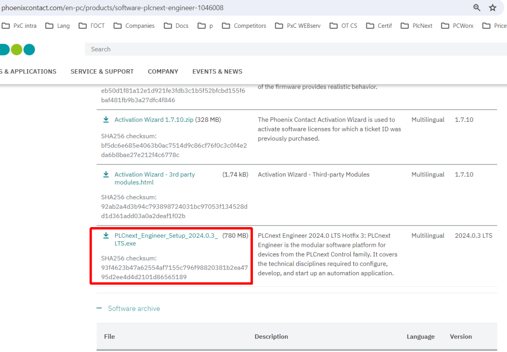

There is PLCN ide 2024.0.3 LTS is now available, but Cyrillic issue is still here. Does some body of support or development team are in touch with this problem. Or it is only one way, pull over to the roadside for a picnic with ide2023-9 for the end of times?..)
Hope some one will pay attention to this.

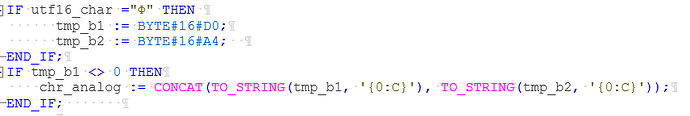

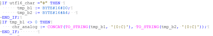

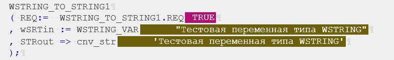

So, now it become more clear, what is going on.
1.IDE 2024.x.x now is more strictly monitor that STRING datatype constants consists only from one byte symbols. And generate warnings, if it is not.
This cause ??? signs for Cyrillic symbol sets, and other, that require 2 byte encoding.
2.STRING datatype now display STRING values as UTF8 encoded symbols. And it is still possible to make STRING display and operate with Cyrillic symbols but you have to decode it from UTF16 of WSTRING to 2 byte UTF8 implementation.
LEN() calculates actual quantity of bytes correctly.
Now IDE display UTF8 STRING in more readable way, then previous IDE versions. Previously, often there was abracadabra
3.This workaround assist me to deal with PLC generated log records to MySQL via DBFL_SQL_8 without additional configuration of MySQL my.ini file. (Previously have to set character-set-server:=cp1251). And DBFL_SQL_8 FB blocks dial with such complicated STRING without errors.
