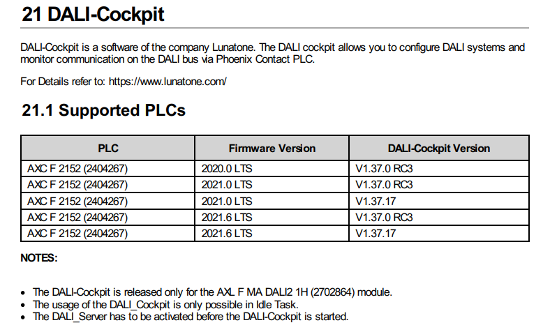

Hi, Is there a configuration app/pc program/plc program for DALI network? I mean a GUI for searching and addressing DALI devices connected to AXL F MA DALI2 1H?
Basically Phoenix equivalent app to WAGO Dali Configurator.
If you are using PLCnext device and AXL F MA DALI2 1H module you can use DALI-Cockpit from Lumatone.
This software is dedicated to work with our PLCnext controller AXC F 2152.
The procedure is described in DALI_Basic library manual (chapter 21):
https://www.plcnextstore.com/permalinks/apps/latest/60002172000203
