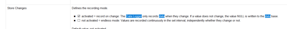

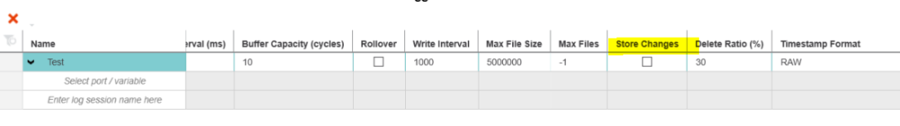

I think the answer to his question is in the “Store Changes” checkbox. The trigger condition starts the data logger, but “Store Changes” option logs data at fixed intervals(not checked) or on value change only(checked).

So you mean, when the logging is triggered it will continue logging, and with ‘value change only’ checked you can use a boolean to log the desired value and only when this change is detected?
I have looked into the datalogger inside PLCnext, but I can not find the latter option; ’ value change only.
I am assuming that writing null uses less memory than writing an actual value.
