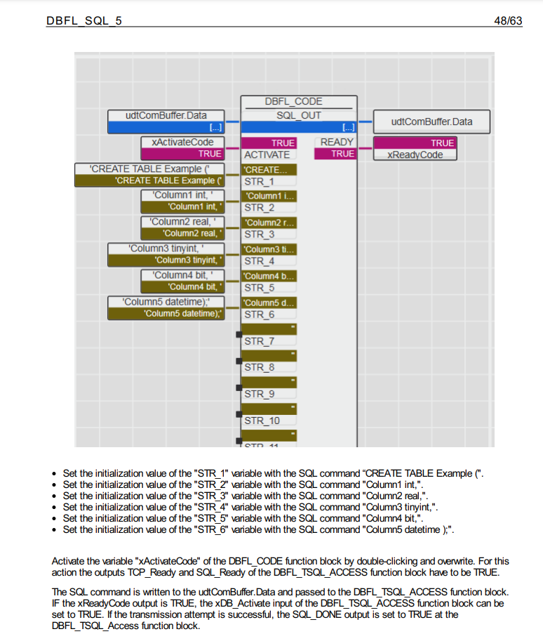

Thanks for your answers! I’ve not worked with db’s before so maybe the questions are quite easy to solve. I have one more question about mysql table. I am able to connect to a database on my PC with the mySQL acces of this library block DBFL_SQL. It also recognizes the DB_name, but how can I specify the name of the table? I have a RCV_SIZE but ROW-/COL_CNT remains zero. I’ve created a simple 3x3 table. Arne
There is a FB called “DBFL_CODE” in the DBFL_SQL library. You will use use the various STRING datatype inputs to write your command. For example, if you want to retrieve the “Title” value from table “Books” where the Author is “Ian Fleming”, you would break up the string “SELECT author FROM Books WHERE author=‘Ian Fleming;’” Page 48/63 in the documentation for the DBFL_SQL library gives a decent break down of this operation, but it uses the “CREATE TABLE” query as its example. Changing this to a different query isn’t a difficult task though. Cheers, Noah Greene

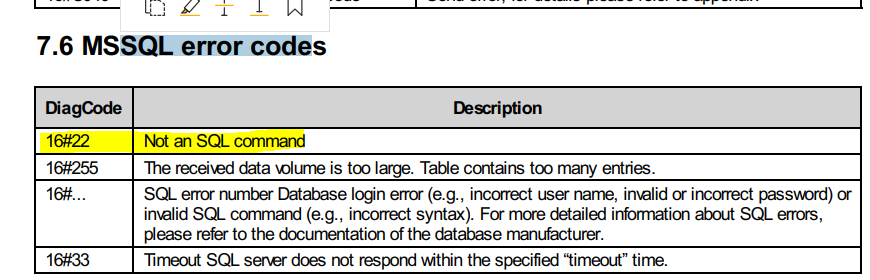

I want to store some data from plcnext in mysql database , i try to use DBFL_SQL but i have an error that thé datagram IS too long.Can you please help me to solve this error.

I can cannect to SQL, create table, but can’t read table command.
The error 16#22 happened
How can I fix it.

Can you please post the command you are sending to read the table?
Can you please post the command you are sending to read the table?</p>
Dear Sir.
The command: “Select * from Example”. This commend is execute in SQL Ok.
Example is existed table in SQL.
