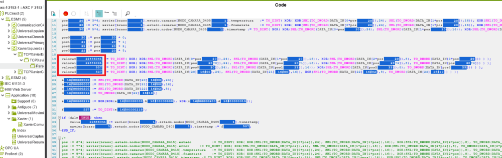

Hello Team,
I working using the library DattaLogger_V2_07, everything fine, easy and helpful, but the times that the variables writes on the CSV file its 4 times per second. I want to know how modificate this parameter, its this posible?.. Regards CT
Hi CT, Sorry for the delay. Here is the reply from the developer:
Yes of course is this possible. If the xReq is triggered a new data set is written into the csv file. So just change the cycle time of the trigger condition.
