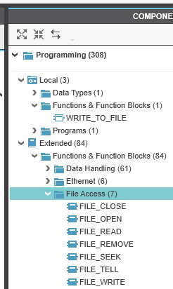

There are at least two ways to write data to the sd card of plc. Using of embedded file access blocks
And using several libraries
Simple logger https://www.plcnextstore.com/world/app/222DataLogger https://www.plcnextstore.com/world/app/348PLCNextBase https://www.plcnextstore.com/world/app/1294 will allow to write data via linux cli.
Please, find sample of FB that write text data to the file on storage, based on file write functions of PLCNengineer IDE without external libraries. Formatting of data have to be relayed on some additional FB/FC.
