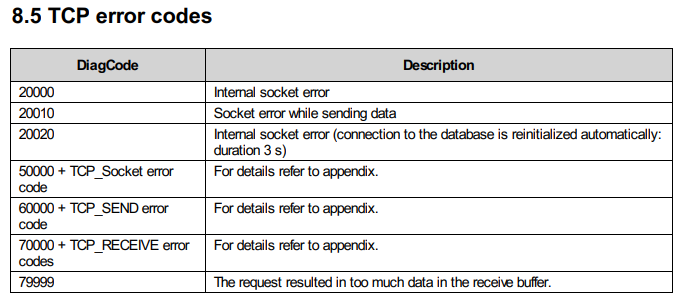

Hello Janne,
the Error Code will be decoded as follows:
99680 - 50000 = 49,680 = 16#C210
This error code comes from the firmware function block TCP_SOCKET_2, please see the Error description below:
