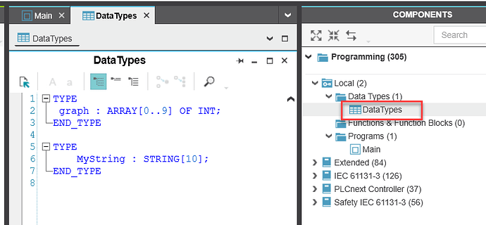

To declare an Array or a custom-length string (ie anything other than max 80 characters) you must first create a type definition for the array or string type, in a Data Type worksheet. That type can then be used to declare a variable in a Data List table in a POU.
You can create a new Data Type worksheet by right-clicking on the Data Types node in the Components area,.on the right of the PLCnext Engineer window.

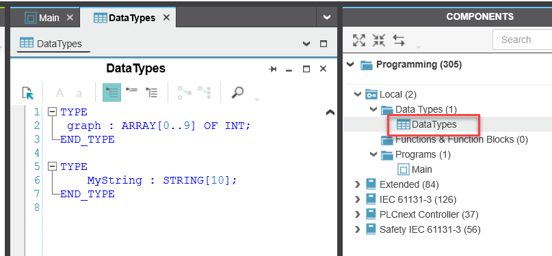

Here are screen shots from PLCnext Engineer using the Array and String examples shown in the help.
Type definitions:

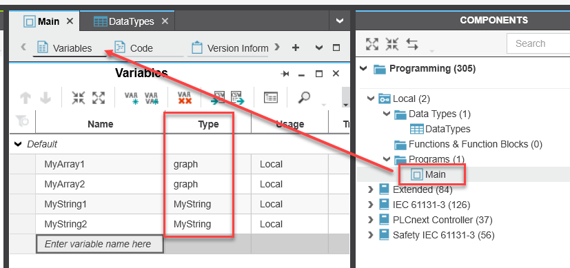

Variable declarations, including multiple variables of the same type:

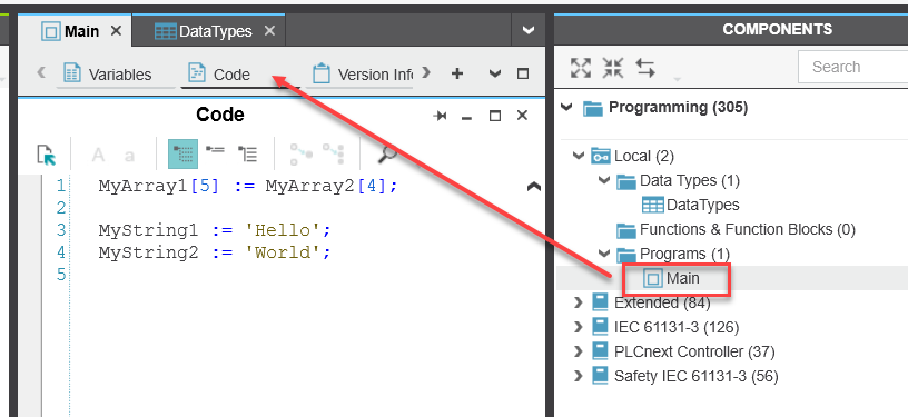

Variable usage:
This is how one type definition can be used to declare multiple variables.
