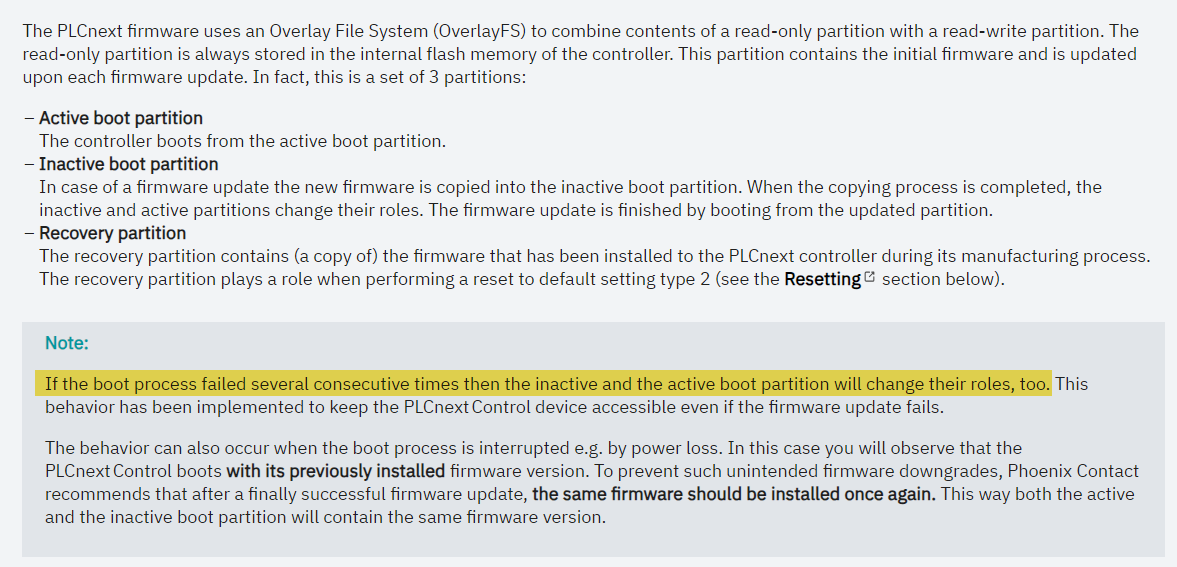

Do you confirm it is nominal behaviour from PLC ?Yes, this is normal behaviour, which is described in the PLCnext Info Center:

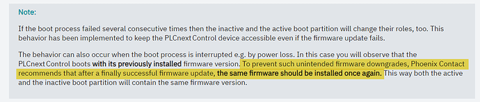

Is there a way to prevent this firmware version restore ?Yes, this is also described in the PLCnext Info Center:
