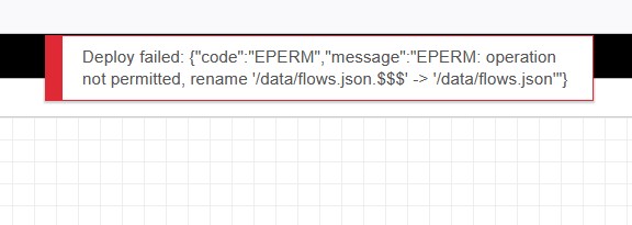

Ran into an error with the latest Node-Red for PLCnext ARM (3.0.2.1) application package.
Deploy failed: {"code":"EPERM","message":"EPERM: operation not permitted, rename '/data/flows.json.$$$' -> '/data/flows.json'"}
The temporary file is unable to write the flows.json file, which is owned by root. I am uncertain of the exact point when this file is created/copied with the store app package. This will be an issue for anyone using this package.
The workaround I found was to chown the file from the PLCnext shell:

root@axcf2152:/opt/plcnext/appshome/data/60002172000507/volumes/node-red# chown tss flows.json
I contacted the developers of that app using the “Contact Developers” button on the app page in the PLCnext Store, and this was their reply:
This is a bug that happens with the newest firmware version in combination with the newest version of our app.The bug is fixed in the new version of the node-red app (3.0.2.2).
Same error here with AXC F 2152 (FW: 2023.6.0) and Node-Red for PLCnext ARM (3.0.2.4). Is there any workaround?
Edit: Worked now for me. Had the wrong app-version.
