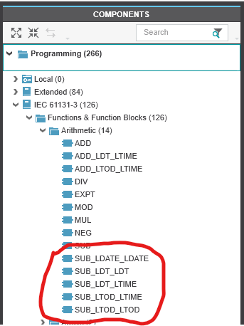

LDT_DIF_TIMESTAMP.zipHi. Please find my thoughts about your question attached. (Project for IDE 2024.0.3 LTS)
Attached sample does not require external libraries.
изображение.pngThe quenue of transformation is:
RTC → LDT → UNIX timestamp (ULINT) → LTIME
This realization allow you to store exact time of event occurrence, and receive time distance of two events with “nanosecond” precision.
BR
Actually, same functionality will provide FC SUB_LDT_LDT, mentioned by DivisionByZero.
Cheers
