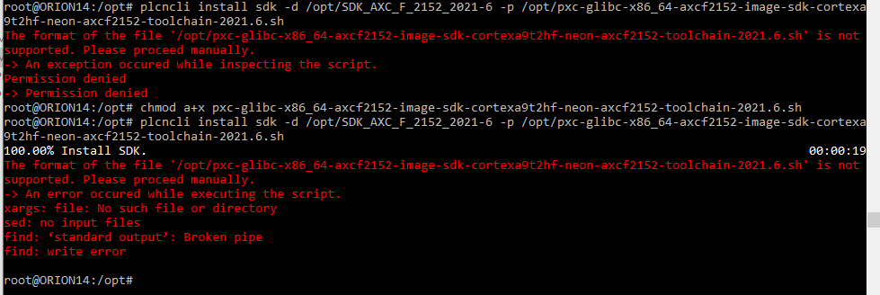

Initially, running plcncli install sdk returned a “Permission denied” error. So I ran chmod a+x. As pictured: [attachment]Screenshot 2021-09-20 165810.png[/attachment] After your suggestion I tried to execute the shell script, leading to a different error. root@ORION14:/opt# ./pxc-glibc-x86_64-axcf2152-image-sdk-cortexa9t2hf-neon-axcf2152-toolchain-2021.6.sh PLCnext Linux SDK installer version 2021.6 ========================================== Enter target directory for SDK (default: /opt/pxc/2021.6): /opt/SDK_AXCF2152_2021.6 You are about to install the SDK to "/opt/SDK_AXCF2152_2021.6". Proceed [Y/n]? y Extracting SDK...................................................................done Setting it up...xargs: file: No such file or directory sed: no input files Failed to replace perl. Relocate script failed. Abort! Permissions of the file are as follows. -rwxr-xr-x 1 root root 228895103 Jul 13 22:45 pxc-glibc-x86_64-axcf2152-image-sdk-cortexa9t2hf-neon-axcf2152-toolchain-2021.6.sh
