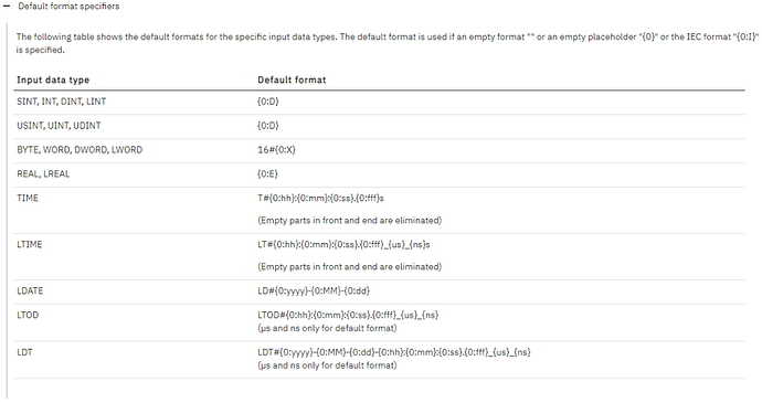

I’ve consulted the PLCnextHelp Engineer documentation and tried the following formats, tried both with and without the tailing s:
  • T#{0:hh}:{0:mm}:{0:ss}s- {0:hh}:{0:mm}:{0:ss}s
However, both attempts result in displaying empty brackets: .
Does anyone have any suggestions on how to achieve the desired format without milliseconds? Any help would be appreciated!
Hello!
You are a little bit missed with documentation line. And as a result give wrong formatting string to function, as a result receive empty brackets…
All you need is in TO_STRING help page, FORMAT STRING / Date and Time format specifiers… And format string ‘{0:hh:mm:ss}’ or ‘[{0:hh:mm:ss}]’, to reduce CONCAT usage.

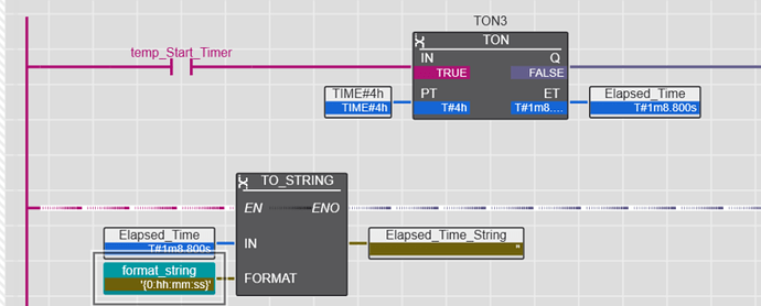

Hello Oleksandr,
Thank you for your suggestion. I did try using the format specifier {0:hh:mm:ss}, but unfortunately, it didn’t work in my case.
Just to clarify, I’m not attempting to display standard clock time. Instead, I’m looking to display a countdown timer with the format:
MaintAlarmStringCountDownTimer := CONCAT('Maintenance - Alarms Suppressed [', CONCAT(TO_STRING(CountDownTimerShutdown, '{0:hh:mm:ss}'), ']'));
Coming from: CountDownTimerShutdown := ShutdownTimer.PT - ShutdownTimer.ET;This is intended to visually indicate that maintenance is active, and therefore some alarms are suppressed, with a maximum time of one hour. However, the result I’m getting with the format you suggested still leads to empty brackets: Maintenance - Alarms Suppressed [].
I wonder if there might be a specific issue with how the TO_STRING function handles the TIME datatype in this context. Any further insights or suggestions you might have would be greatly appreciated!

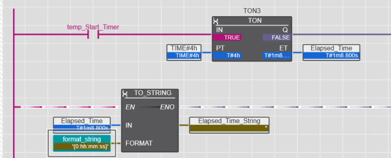

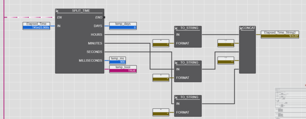

I attempted to set up your problem – I simplified it to just be a timer (instead of countdown timer); I got the same results as you…there is no output from the To_String function with the ‘{0:hh:mm:ss}’ format.

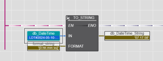

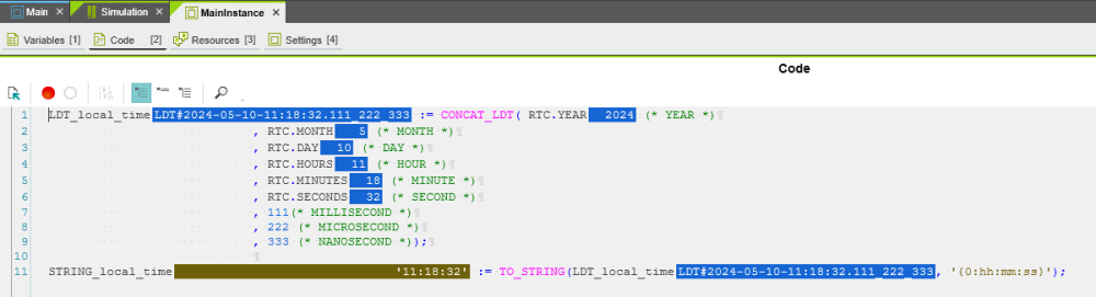

Out of curiosity, I used the same format string ‘{0:hh.mm.ss}’ to a LDT variable (not just a TIME data type) and the output worked:

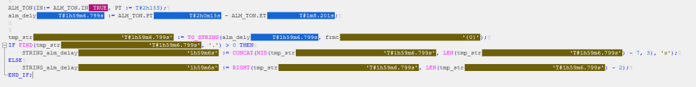

One way around this might be to use the SPLIT_TIME function, convert the pieces to strings, and then CONCAT them. A little cumbersome but it works…

An easy work around is to convert TIME to INT and divide by 1000 (conversion gives ms)

Hi, actually TIME datatype consists 32bits OR DWORD, so it can be freely converted to DINT datatype, with TO_DINT().
Other conversion could be provided like a chain of subsequent conversion functions calls, if necessary.
