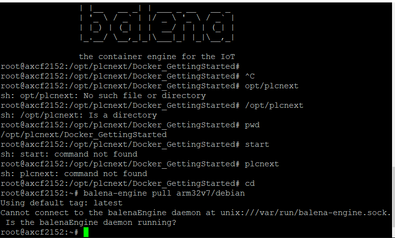

sorry, i dont know the command for change directory from 0:34 to 0:35, i try the command : ’ cd’, it’s not successfull, Sorry, I’m new to putty and basic commands
The controller was actually restarted between 0:34 and 0:35.
It’s not necessary to change directory before pulling an OCI image, but this is possible using the cd command, e.g. cd /opt/plcnext

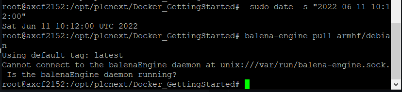

What firmware version is running on the controller?
Do all your installation steps look identical to the steps in the video, up to the point where the problem happens?

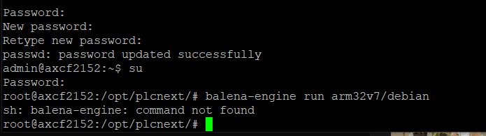

sorry sir, it took me more than 1 month to install docker still not working, from 0:34 to 0:35 in the video, i type sudo recover plcnext 1 to reset type 1 and continue, but still not working, Can you specify the command lines you use from 0:34 to 0:35?
i’m using the latest firmware
[https://forum.plcnext-community.net/uploads/K01E7DZYOYCU/image.png</a></p>sorry sir, it took me more than 1 month to install docker still not working, from 0:34 to 0:35 in the video, i type sudo recover plcnext 1 to reset type 1 and continue, but still not working, Can you specify the command lines you use from 0:34 to 0:35?</p>i’m using the latest firmware</p>
thanks, i have installed succesfully
