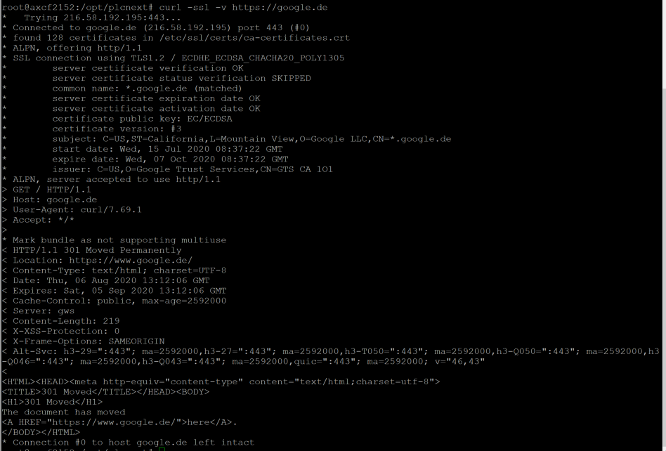

Hi Dan, the script does not download the docker bin. 1.) Has the controller internet access? 2.) Can you please give me the output of “curl -ssl -v https://google.de”

                                             1. The controller does have internet access.
                                             2. See attached picture.

Hi Dan, the installation script for docker has a little mistake. I have fixed it. The actually version is on GitHub. Greetings, Jan
