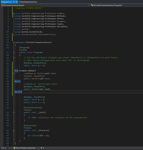

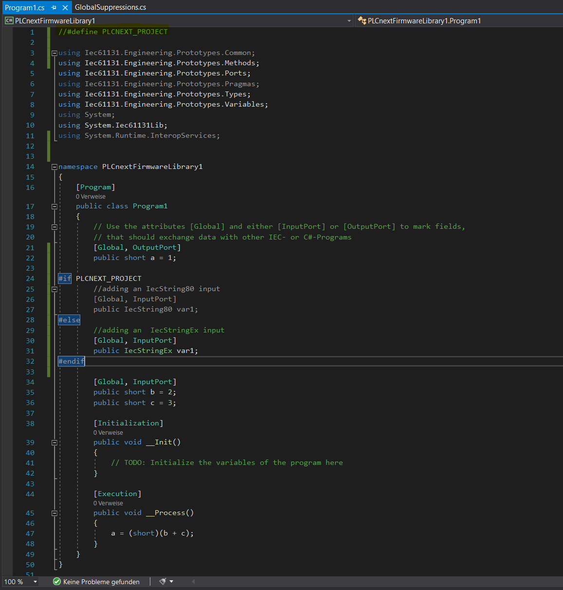

Hello Joshua,
please see the example below, I can’t see any errors:
BR Eduard
Hi Eduard,
Your code example is using C#.
Can you please try using C++ which uses #ifdef #ifndef ?
