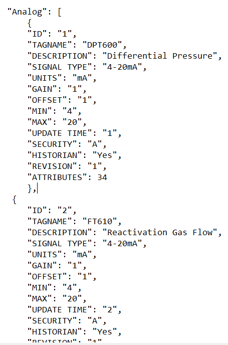

I have used the dynamic ports example in C++ from Github and I was able to run it successfully. However, I would like to expand the project and add more tags - Boolean and real tags. Does the attributes in the Json file provided in the example have a significance (I imagine 36 for output and 34 for input )? Is there a documentation or example that helps us expand the scope provided.
Here is the sample of what I am looking for. Need all these variables to do some logic in C++ and as well as have them in the GDS.

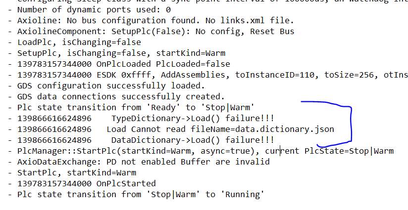

I copied the json file to plcnext controller and see the following message and no dynamic ports were created.
Not sure if the Json file format is incorrect or something else is wrong. Please help.
