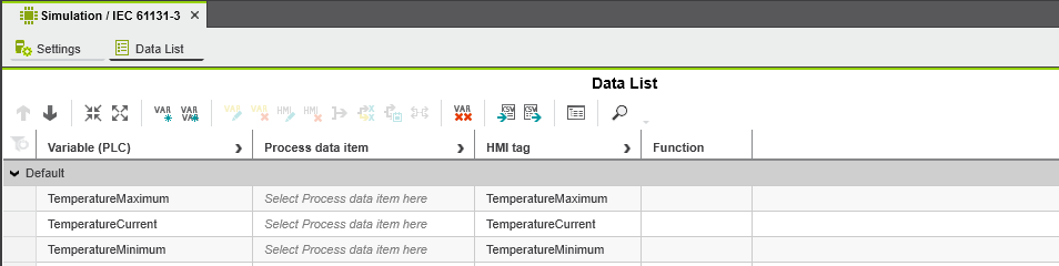

I converted a project to 2023 LTS a while ago now and have come to notice that I don’t have any columns past Function in the IEC 61131-3 Data List. I can’t do retain, etc. Local variables show those columns fine. I access my global variables as Externals from programs. I’ve updated from 2023.0.1 to 2023.0.5 as I had 2023.0.4 on another engineer’s laptop and they had the columns just fine in a project. Any idea?
New projects do the same, so I don’t think it’s the project itself.
I tried a full uninstall of 2023 and reinstall. No luck. However, I have older versions here too that are doing the exact same thing (2022 LTS and 2022.3), so I’m thinking its some configuration issue. I haven’t tried a mass uninstall of every version yet.
IEC variables looks identical to all the other data list (Axioline, Profinet, etc), just a slightly different order of columns (Variable (PLC), Process Data Item, HMI Tag, Function).

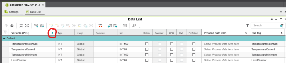

Hi Gerald,
did you try to expand the variables column in the data list?
Cheers
