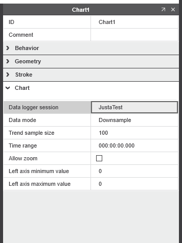

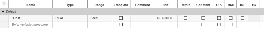

So I was fiddling around with the program and settings, figuring out why not make it anew. So I did, this is what I found (see screenshot attachments). To my understanding this hints to a bug…
Can I get an confirmation on the matter?
For now I’m gonna switch back to 24.04LTS again…
Task and Events page
mgnKBgIgib.pngData Logger Sessions
PLCNENG64_6SijntoynL.pngVariable in JustaTest
Settings Chart1
Error Message

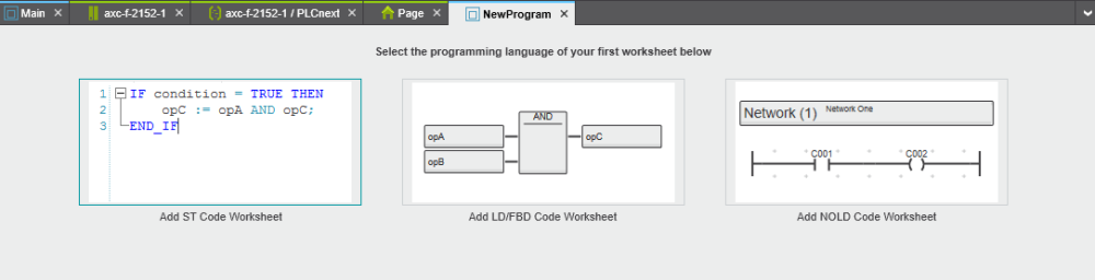

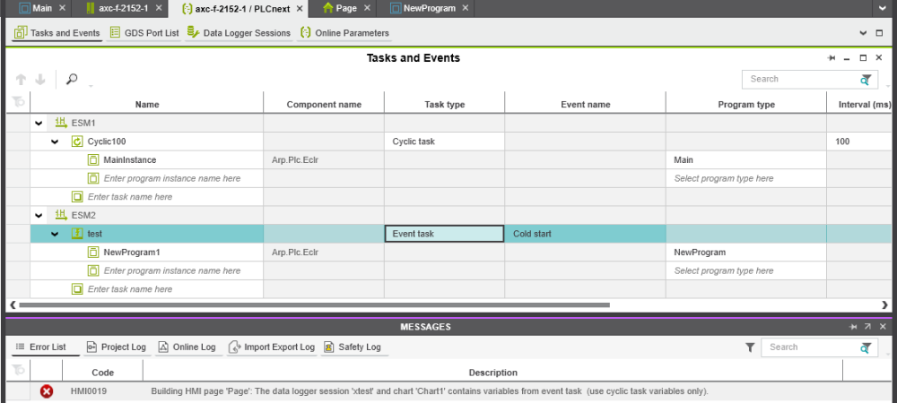

Question: Are All tasks cyclic? I’m able to reproduce this error message by simple adding a non cyclic task (that does absolutely nothing)
For example: my event task runs the NewProgram (does nothing as you can see) but still generate the same error message even thought the test is a cyclic taks.

Hi [@fluxmodel</a></p>Question: Are All tasks cyclic? I’m able to reproduce this error message by simple adding a non cyclic task (that does absolutely nothing) </p>For example: my event task runs the NewProgram (does nothing as you can see) but still generate the same error message even thought the test is a cyclic taks.</p>[https://forum.plcnext-community.net/uploads/G3AL4AK01I8Q/image.png</a></p>[https://forum.plcnext-community.net/uploads/RRSXR4174QK6/image.png</a></p>Best regards</p>
No - i was mistaken in my prev post.
I have two event tasks (exception and stop) - but their variables was not connected to the graph in any way.<

Hello &
The error message you’re encountering typically appears if there is any task type other than a cyclic task configured in the ESM. This happens regardless of where the recorded variable is used.
I’ve verified that this issue has been addressed in the upcoming Hotfix 2025.0.1, which is expected to be released within the next two weeks.
