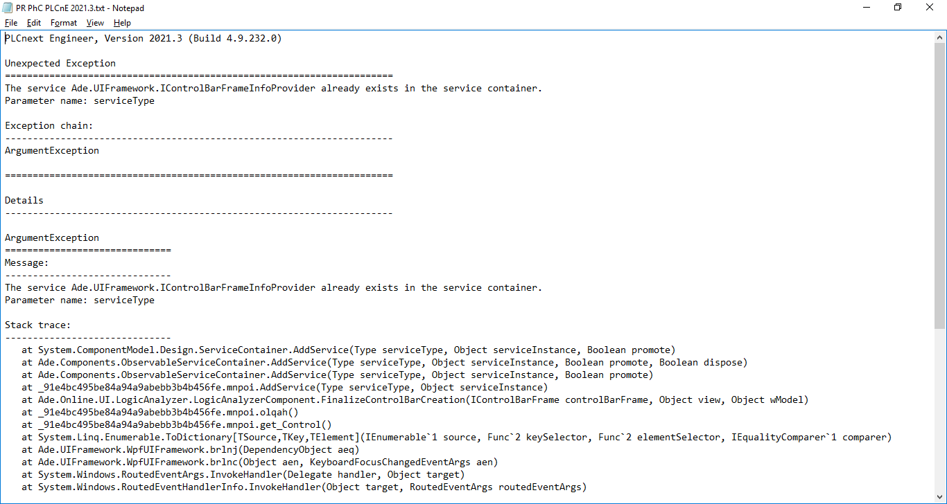

Point 2, 3, 4, 5 are only for information purposes for actual configuration. Main issue is with point 1. 7. I have installed PLCnext Engineer 2021.0.2 on virtual machine Windows 7, there was no error such as in point 1. I did configuration and downloaded program without problem. 8. As I start PLCnE 2021.3 (not VM) there is balloon on right/down corner with the following message: Safety notification: The language profiles could not be found. 9. When program is opened these errors are active without doing nothing (empty project): Error\tSLPP1004\tSafety violation! The language profile ‘Limited Variability Language (FBD)’ has no valid safety seal. Error\tSLPP1004\tSafety violation! The language profile ‘Full Variability Language (FBD)’ has no valid safety seal. Error\tSLP00008\tInvalid safety seal for the safety library ‘Safety IEC 61131-3’. I have made temporary solution with VM, but I want to use it without VM. 10. Is there error list help? 11. Also in VM I have installed PLCnext Engineer 2021.3 but program crashes. Please find problem report attached.

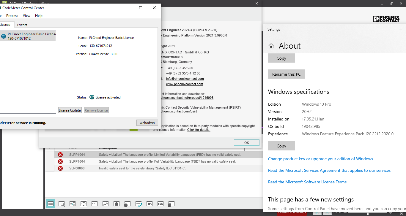

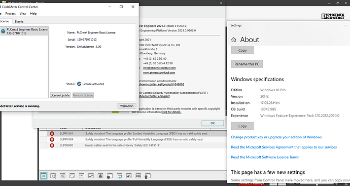

You mentioned that your virtual machine is running Windows 7. What version of windows is running on the host machine? PLCnext Engineer requires Windows 10: [attachment]2021-05-17_8-33-07.jpg[/attachment]
Please see picture. Those errors are active!

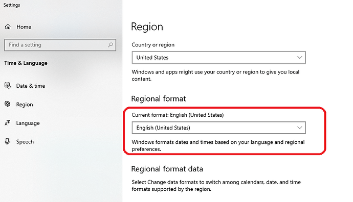

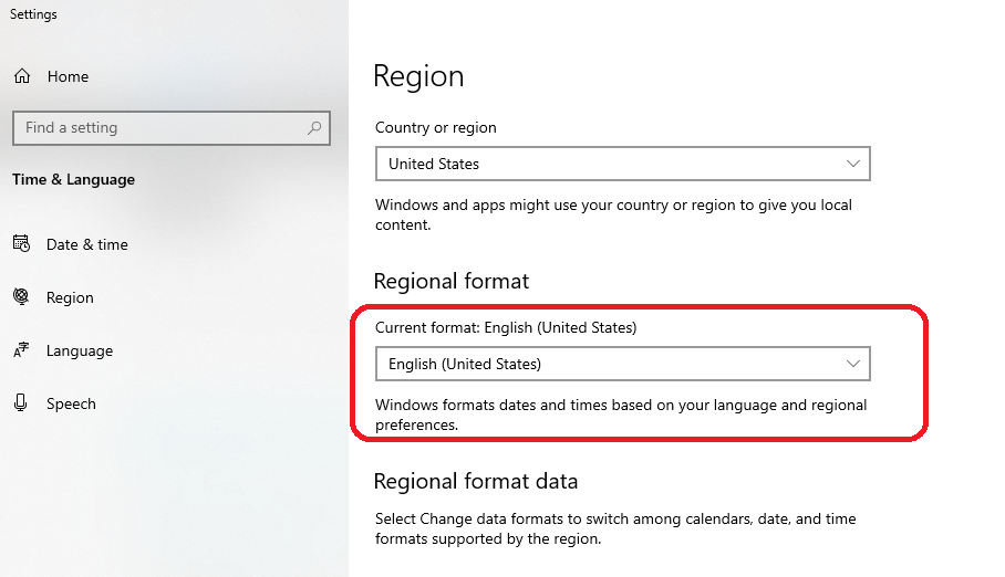

I have found solution to the problem. In regional settings, regional format should be United States, not local (in my case Albania). Maybe support team will make solution for that in future.
