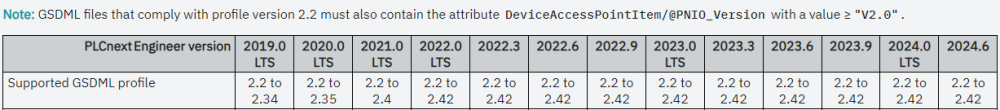

I’m sorry to inform you this, but PLCnext Engineer requires at least a GSDML Profinet version 2.2 as described in the system properties.
You say that you have all kinds of older modules, which ones? Maybe some of them do have Profinet version 2.2 or higher.
