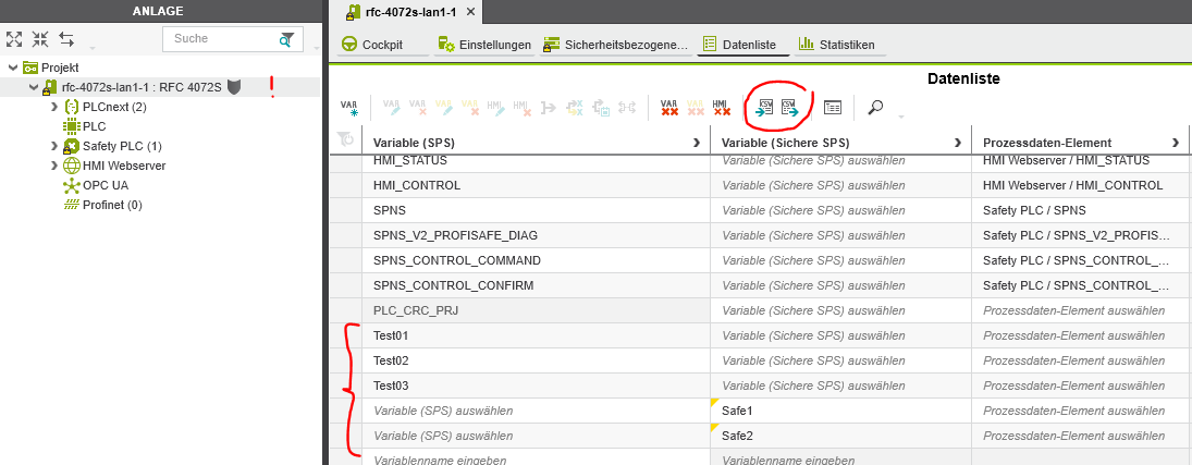

Hi, I exported variables from PLC data list and then tried to import them to another project but only the safety variables were imported. Is this a known issue? Br Stefan
[quote]please check with 2021.6 the following parameters ? It was not reprodcable to see the behavior you had explained. Both types of variables can be imported by the softkey.[/quote] [attachment]inline1625264903.png[/attachment] (ref: #219098)

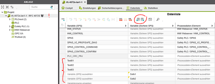

Hi, Thanks for the reply. I found the issue that caused the problem. When a data type is missing no variables are imported to the non safe plc. The pop-up does not clarify the problem but in log in project tab it is shown Br Stefan [attachment]Screenshot 2021-09-08 070745.png[/attachment]
