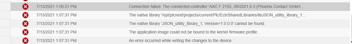

Hi Eduard, Thank you for the github link. It is easier to understand and learn what is happening in the example code. However, when i tried to start and write this example into the PLC, i got this error.
Hello shkhmaaz, I opened the example in PLCnEng 2021.0 and 2021.3 and downloaded it to the PLC without errors. Please give me information about the used PLCnEng version and PLC FW Version. Thanks & Best Regards Eduard

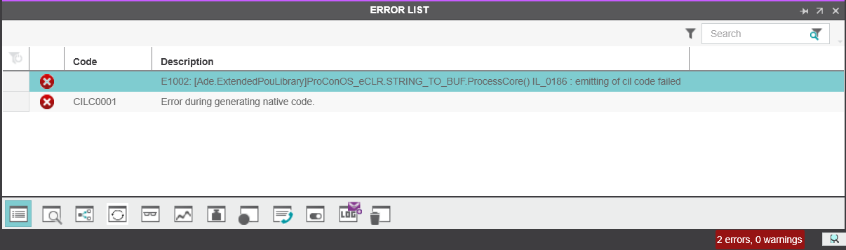

Hi Eduard, My PLCNext Engineer version is 2021.3.1 and the PLC FW version (on the software) is 2020.6.0. Can that be an issue? Edit : I deleted the old FW version and updated it in the Software. Now it is giving me another error. Edit 2 : I fixed the error and tried the example one time. It worked perfectly fine. Next, i wanted to replace the print to buf function block with print to file function block. After that, it gave me an internal error and said “Online mode is not possible” and gave error CILG0001. Even after undoing everything im getting the same error Edit 3 : Fixed it again :stuck_out_tongue: Now, can i export this JSON data to a JSON file on the plc?
Hello shkhmaaz, yes it is possible to export the JSON data to a JSON file on the plc. I think it is a application issue. Could you provide me your project via following, not secured link (I will check the application): Error If it’s not possible, can I contact you via E-Mail ? Best Regards Eduard

Hello shkhmaaz, as discussed via email in your project, the IIoT library (content JSON utility and MQTT client libraries) and the JSONutility library was added separately. In the furher we will remove the JSON utility and MQTT client libraries in PLCnext Store and the Librarys will be only part of IIoT Library. Best Regards Eduard
