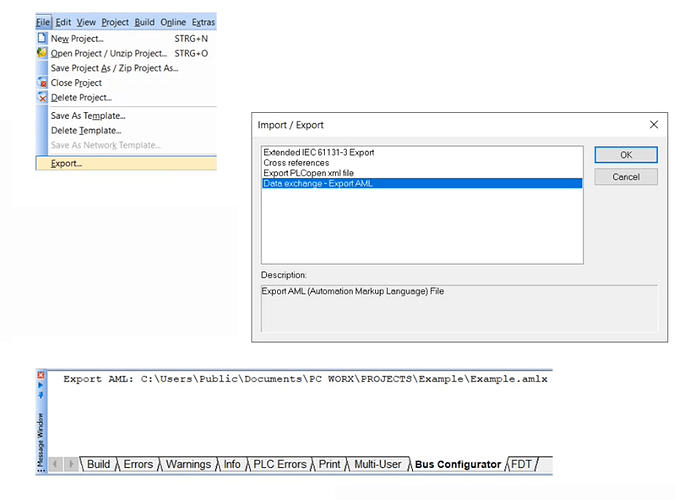

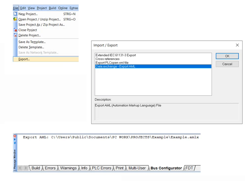

I am currently investigating the possibilities (and impossibilities) regarding the conversion of an existing PC-Worx program to PLCNext. From this forum and some other internet posts I understand that ‘the way to go’ would be to export the program as .AMLX file and then import that into PLCNext.

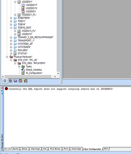

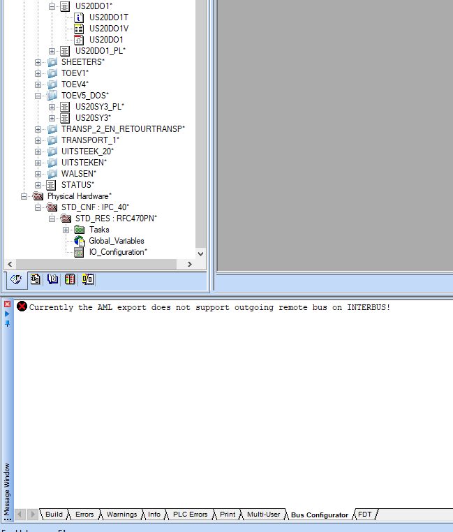

I have downloaded the latest PC-Worx version and also installed the AML_Export function. So far, so good. After rebuilding the program, I can start the Export to AML function. Unfortunately, it stops, throwing this error:
How can I proceed? At this moment, no .AMLX file is generated at all .

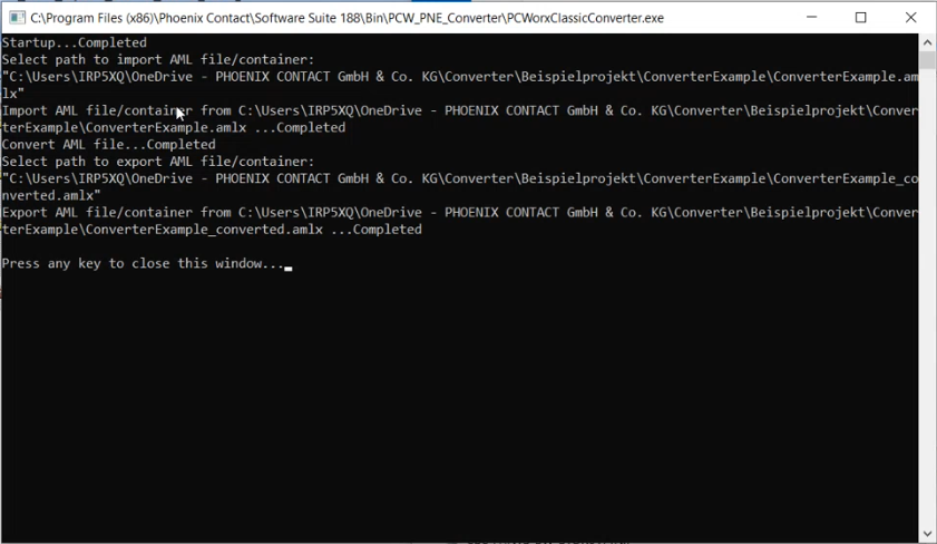

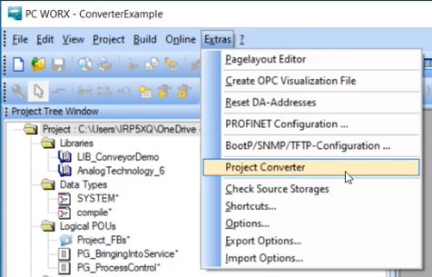

Here is the answer from the Controls Support team:<\/p>please keep in mind.<\/p>**Currently the export of the Interbus remote bus is not possible. <\/strong><\/p>Follwing procedure is possible:<\/p>[https:\/\/forum.plcnext-community.net\/uploads\/HXLF3V53CZ65\/image.png<\/a><\/p>[https:\/\/forum.plcnext-community.net\/uploads\/9SPB3U73GRTG\/image.png<\/a><\/p>[https:\/\/forum.plcnext-community.net\/uploads\/HXTND3WE9ZIE\/image.png<\/a><\/p>**System differences: <\/strong><\/p>- FUs for explicit type conversion are no longer available.<\/p>   E.g. INT_TO_DINT() -> Use generic FUs e.g. TO_DINT() Data type TIME has changed -> 32 bit signed! Format specifier for character string conversion has changed. -> Old format identifiers are no longer compatible! <\/p>   E.g. TO_STRING(iVariable, 'Number: {0:d}'); Old ProconOS MEM*\/IMEM* drives are no longer available. -> Replace with MEMORY_COPY \/ MEMORY_SET. <\/p>- Strict typing! Memory area beyond the linked variable cannot be addressed. -> Memory access beyond the type limit is no longer possible. <\/p>- IP blocks have changed. -> Reimplement with TLS_SOCKET_2. System event tasks are not automatically converted. -> Create manually A free-running task watchdog is not accepted, only the set watchdog time is accepted. -> Set watchdog to 0 to deactivate it. <\/p>- When importing global variables, do not import the system variables. These overwrite the assignment of the existing system variables. <\/p>- The system variable PLC_SYS_TICK_CNT is no longer available -> create your own millisecond counter.<\/p>- The system variables of the system time RTC_* are no longer available -> time is available via the global variable RTC. This is now a structure.<\/p>- The Instruction List (IL) programming language is no longer available -> code must be converted manually.<\/p>
Hello  and all,
OK, I have received some more information and now I understand your answer (a bit more). One must export the .amlx file from PC Worx and then use that .amlx file as input for the 'Project converter'. My problem is obvious: I cannot export the .amlx file in the first place!
Apparently my old PC Worx project **does** have Interbus remote bus nodes, so the initial export fails. Is there no known 'work-around', for example replace the 'Interbus remote bus' with another type?
