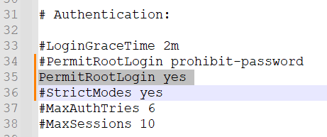

To enable root login you have to set root password and enable root login via ssh.
https://github.com/plcnextusa/PLCnext-Guides/blob/master/Appendices/Appendix%204%20How%20to%20create%20a%20root%20user%20in%20SSH.pdf
And edit /etc/ssh/sshd_config file
And reboot plc or restart sshd service.
