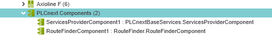

If a referenced library directly creates an instance of a PLCnext component in the PLANT tree, “Download changes“ is rejected by the controller. A complete project download has to be executed.
So the questions would be:
Do you use PLCnext compnents in your project?
and
Do you execute a “Download change”?
Cheers
DivisionByZero
Yes, it seems bingo case… Both of conditions is matched…
