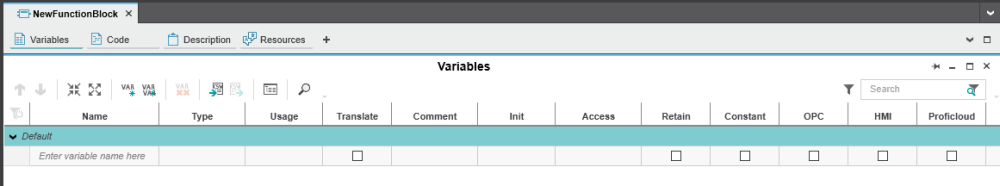

Hi, I need assistance with the development of a custom Function Block in plcNext engineering using ST if I am not wrong. This is my first time and don’t have experience. Copied a code in ST to the engineering after following the procedure to add new FB and has a lot or errors.
Thank you for your assistance in advance.
Randy
Hello!
As you make your code by advanced copy-paste method))) you meet with errors of undeclared variables and additional fb calls, that does not declared in Variables part of new fb structure.

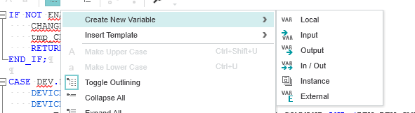

So you have to declare new variables at first. And set it additional options, such as Input/output and data type…
And after commisioning
This will fix most simple error warnings in this case

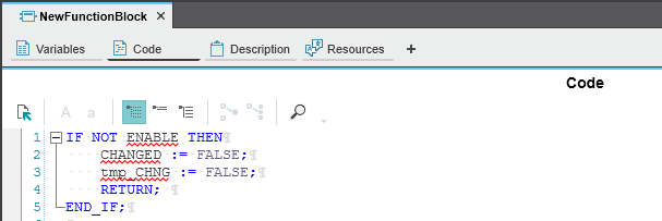

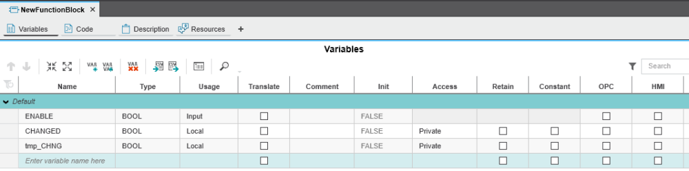

This is part of the code that we want to use, can’t declare the variables either.
Ok, this is far from the ide declaring style.
                              * PLCNext Engineer does not support METHOD, VAR, BEGIN keywords in manner you try to copypaste. It seems to be more close to PASCAL or BASIC code sample. It have to be deletes from code.
                              * Using REPEAT UNTIL in this case (exit condition is determined by user input) will cause watchdog exception.
                              * There are additional FC/FB calls 'IsCellNumber()', 'ReadInputString()', which have to be declared in separate POU's
This sample have to be deeply refactored for using with PLCNext Engineer.
