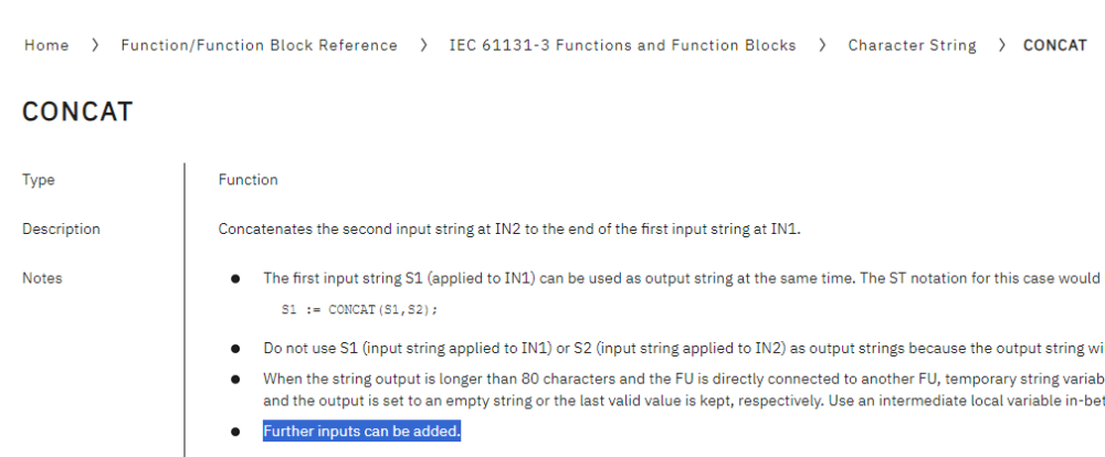

I am writing to follow up on an answer I received via email from Phoenix Contact regarding the use of backticks in the PLCnext Engineer interface, which was mentioned to have been shared on the forum as well. Regrettably, this explanation is not visible (anymore) in the forum discussions. For the sake of clarity and to aid others who might have the same thoughts, I was hoping to see this detailed response posted publicly. The content of the email was as follows:
_" We have discussed this topic with our development and PM and have come to the following conclusion. We see the benefits of using backticks as in JavaScript. However, the ST language is defined by the international standard IEC 61131-3 and we have implemented our editor according to it.__Furthermore, the second CONCAT command in your example line is not necessary._fullString := CONCAT( 'Hello PLCnext community, it’s ‘, TO_STRING(dayCountDown, ‘{0}’), ’ days till the new month start’);"
I would appreciate if this could be addressed, ensuring that the information is accessible to all users on the forum, which would greatly contribute to the collective knowledge base.

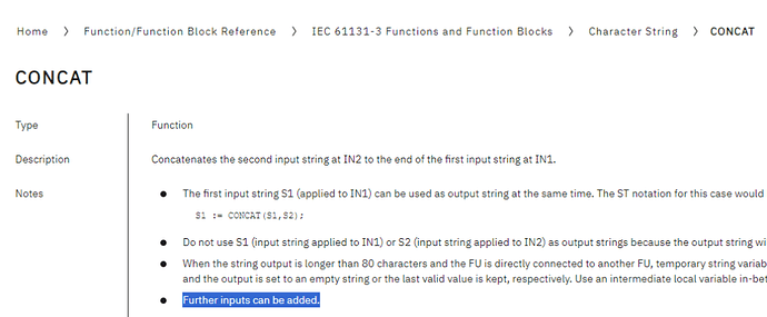

I looking through manual thousand times but never noticed this before… It seems that this option have to be bolded and placed in the head of list)
There are a few functions that can have inputs added, e.g. the logic functions:
result := AND(bit1, bit2, bit3);
result := OR(bit1, bit2, bit3);
result := XOR(bit1, bit2, bit3);
CONCAT is just another example of a function with this feature. Note that it’s possible to add inputs in both the ST and the FBD versions of these functions.
