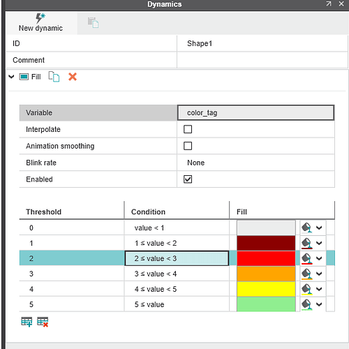

Hello!
Wish it could be possible to set fill/border/line color as hex code in variable e.g. color_tag := 16#FFAABBCC where FF - opacity, AA - hue, BB - saturation, CC - brightness, or opacity + RGB code. I mean variable directly encode color and not use predefined set of colors, as it used to be for now. Does some body else find it out useful feature?
BR.
Hello!</p>Wish it could be possible to set fill/border/line color as hex code in variable e.g. color_tag := 16#FFAABBCC where FF - opacity, AA - hue, BB - saturation, CC - brightness, or opacity + RGB code. I mean variable directly encode color and not use predefined set of colors, as it used to be for now. Does some body else find it out useful feature?</p>[https://forum.plcnext-community.net/uploads/KR0BQ02DPFAB/png.png</a></p>BR.</p>
I definitely would like that.
It opens up a new world of design possibilities i was already accustomed to from the Bachmann-environment.
Just to use color variables inside the HMI editor would be very welcome, so that changing the color one place changes its use over the whole project. Imagine how easy it would be to create or enable dark mode/light mode with such a scheme. (this is btw a requirement in marine approvals for HMIs used in bridges due to night vision)
