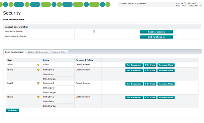

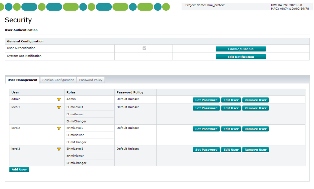

For sample, please create 3 users level-X with different HMI access levels, as shown on pic.

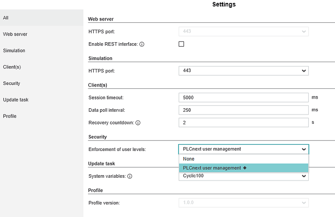

изображение.pngAnd enable standard auth control at project settings

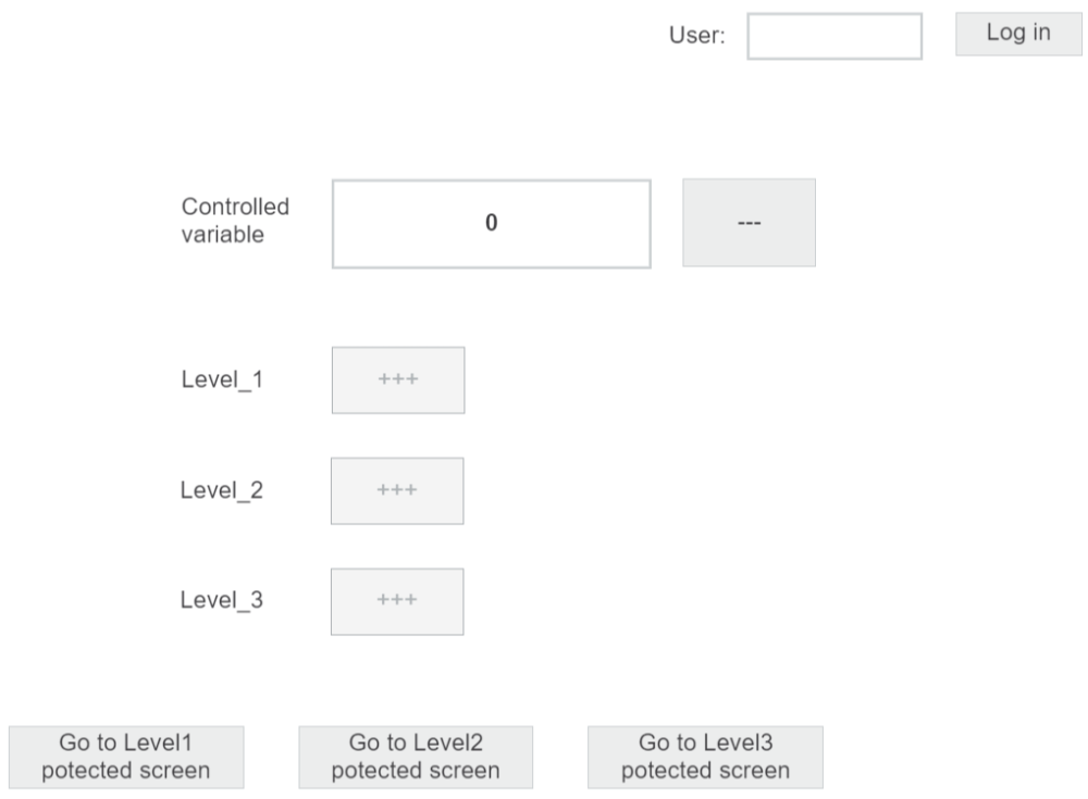

изображение.pngAfter download project you will see main page, where you can see some control and navigation buttons with control restrictions depends on user logged in or not.
hmi_protect.7zизображение.png There you will find out page and button control restrictions properties, just as you suspect.
I messed up with this sample, it use just local hmi variable. As soon as you try to use or add plc variable to main screen, it will demand user authentication, regardless any other page settings… So initial login to web-hmi page hardly could be skipped, if user enforcement is activated.
