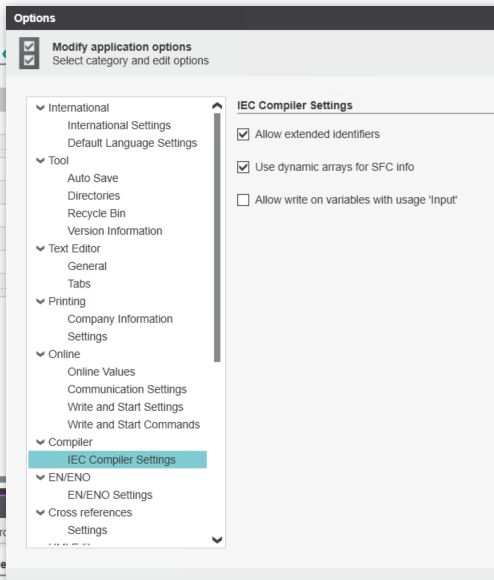

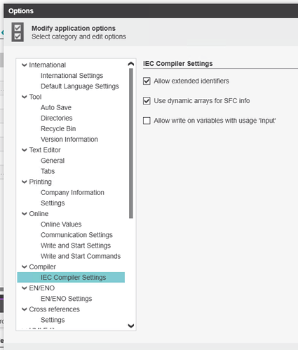

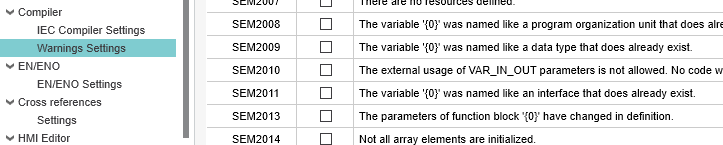

imo you can simply ignore the warnings? I use PLCnextEngineer 2023.0.1 and there is an option to hide this warning entirely.
If you want to use your new output you’d have to open the code worksheet and update the function block call anyway.
Cheers
DivisionByZero
I don’t see that option ? ( V2022.6 So I can get the simulator working)
