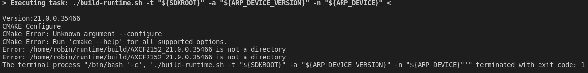

I have installed Cmake on the host and now get this error: [attachment]Screenshot_7.png[/attachment] i have also noticed that nothing is pressent in the SDK install folder after installing it. is this normal?
What version of cmake did you install? The version that comes with the latest SDKs is 3.16.5. sysroots/x86_64-pokysdk-linux/usr/bin/cmake --version cmake version 3.16.5 The --configure option might not have been supported before a certain version. [quote]i have also noticed that nothing is pressent in the SDK install folder after installing it. is this normal?[/quote]No, this is not normal. How did you install the SDK?
I am using version 3.20.3 of CMake. as for how i installed the sdk, i used this tutorial: Redirecting...
Hmm, interesting. Both cmake v15 and v16 seem to “support” the --configure option, or at least ignore it, while v20 doesn’t like it at all. The quick fix is to delete the –configure option from the build script (this works for me). I will log an issue in Github and this will be fixed in future. As for installing the SDK - the official way to do this is described in the Info Center, here: https://www.plcnext.help/te/Programming/Cpp/Cpp_programming/Required_Installations.htm If this procedure does not install files in your specified SDK directory, please let us know.

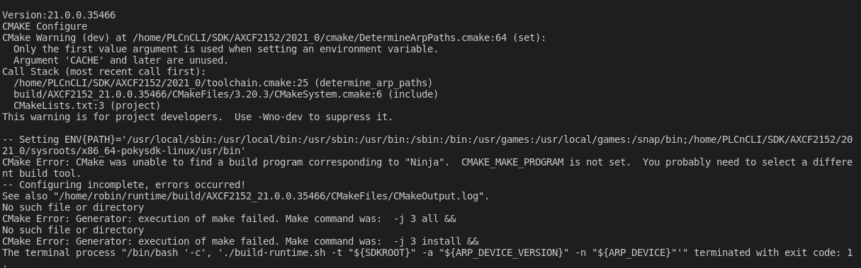

i have commented –configure but now get new error codes: [attachment]Screenshot_8.png[/attachment] i have also used the tutorial to install it but the folder is still empty after installing. i am using Ubuntu version 20.04.02.0 running virtual box version 6.1.22

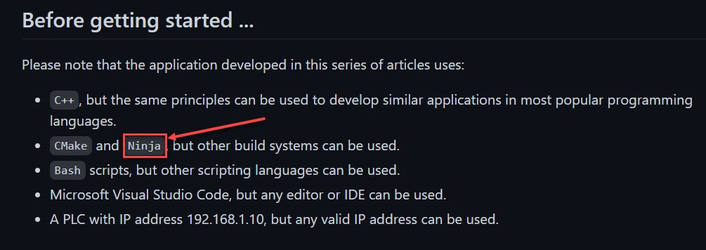

It’s saying that it can’t find the build program “Ninja”. From the Readme: [attachment]2021-06-10_15-25-48.jpg[/attachment] You will need to install Ninja, or use an alternative build program. .
That fixed it ,thanks a lot for your help Martin.
