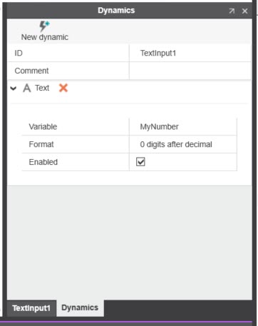

Hi, please try a Text dynamic linked to a numeric variable, like so: [attachment]2021-08-09_17-04-01.jpg[/attachment]
Thanks for your help @Martin PLCnext Team# .
