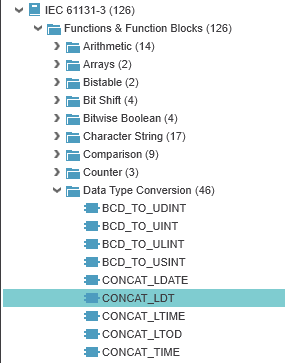

Hi!</p>[https://forum.plcnext-community.net/uploads/OOSQ0MF51CJK/d0-b8-d0-b7-d0-be-d0-b1-d1-80-d0-b0-d0-b6-d0-b5-d0-bd-d0-b8-d0-b5.png</a></p>Try this one embeded fc.</p>
Thank you, although it would be a little bit strange to concat data from RTC into LDT, then convert it into string…
So it looks like PLCnext doesn’t have a standard function to obtain current date and time in LDT…
Yes, I also format the INT values with CONTACT_LDT, going backwards with SPLIT_LDT.
In the LDT you can easily add time zones and summer/winter time. From the LDT you can use TO_STRING to output the desired format (STRING#‘{0:dd.MM.yyyy - hh:mm:ss}’ or STRING#‘{0:hh:mm:ss}’ or STRING#‘{0 :dd.MM.yyyy}’)
