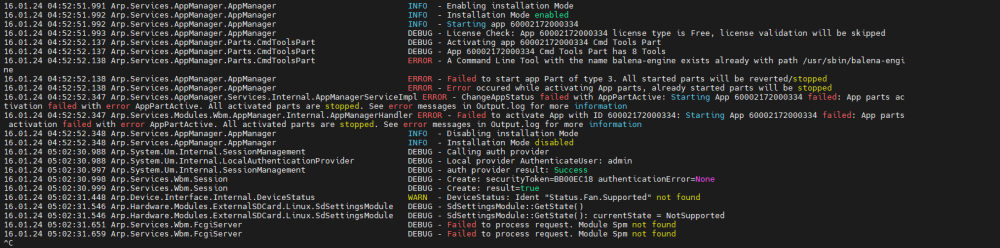

I installed the engine like img1
img1 )

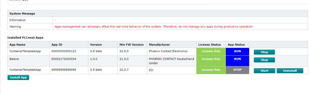

If use it with img2, there is no problem ( in /opt/plcnext/apps/60002172000334/bin )
img2)
2.PNGI want to register directly with PATH and use it like img3 . but just installing the app does not register PATH.

3.PNGWhen I directly copy the bin file to usr/sbin, there is a problem when I start the app.
img4 )
How can I register balena-engine in PATH?
