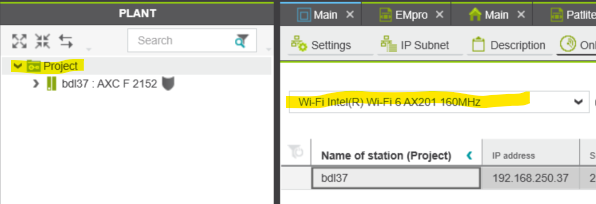

Can you confirm you changed your network adapter in the Project page?
SFW
Yes, I confirm that
