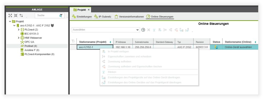

double click the ACF F 2152 node in the plant (Anlage) and open the Cockpit editor. There is a connect button in the toolbar. You can also open the context menu on the same node and hit the connect entry.
What you see in the screenshot is this:
PLCnext Engineer Online Help
Hi WhiteKnight,
In the following Screenshot, you scan for PN-Controller. Please choose in the first step the Ethernet Adapter and in second step click on “Scan the Network Button”. In this sheet you can assign the PN-Name and IP-Address to PN-Controller.
image.pngFor Connection and Deploying the Project, please see the answer from DivisionByZero.

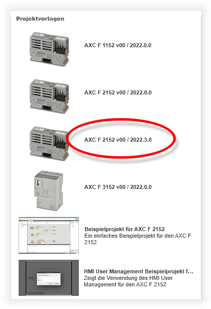

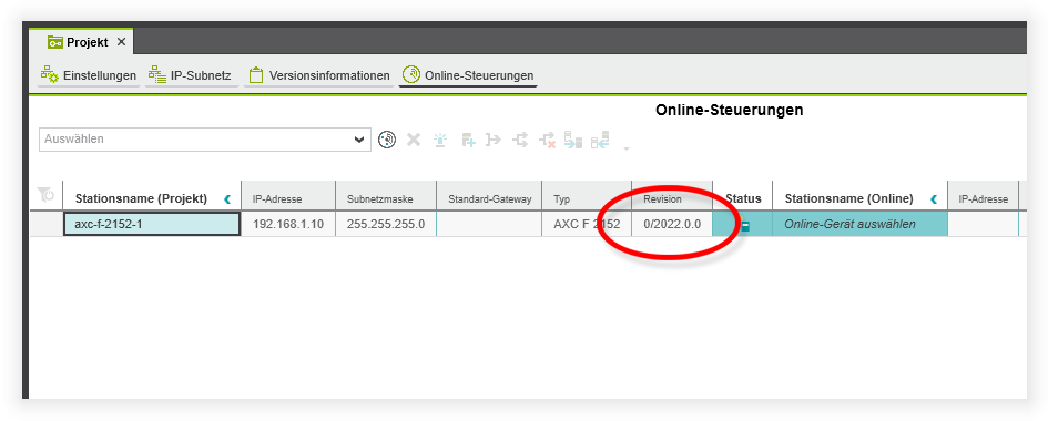

I finally found the solution to the issue:
My mistake was that I selected a project template that didn’t match the actual controller firmware:
I think the error messages issued by PLCnext Engineer should greatly be improved. Currently, they do not provide helpful hints. In this case, they even didn’t reflect the actual issue.

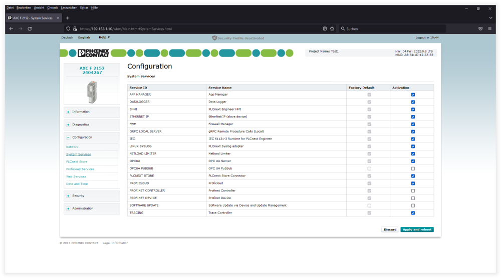

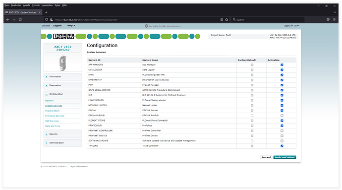

These are the system services currently being active on my device:
Does this information perhaps shed some light on this issue?
I’m using a pre-owned ACX F 2152. Perhaps a factory reset may help? What kind of reset type would you suggest?
Is there perhaps some sort of a PLCnext troubleshooting CLI tool available that’d be checking the controller’s configuration for different aspects?
Yes that explains it.
The device discovery in PLCnext Engineer uses the Profinet DCP protocol, which (as DivisionByZero mentioned) is disabled when Profinet is disabled on the device.

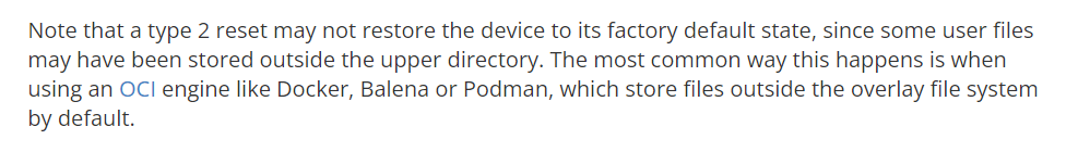

A Type 1 reset and a firmware upgrade should restore the device to (almost) new. This disclaimer also applies to a Type 1 reset:
