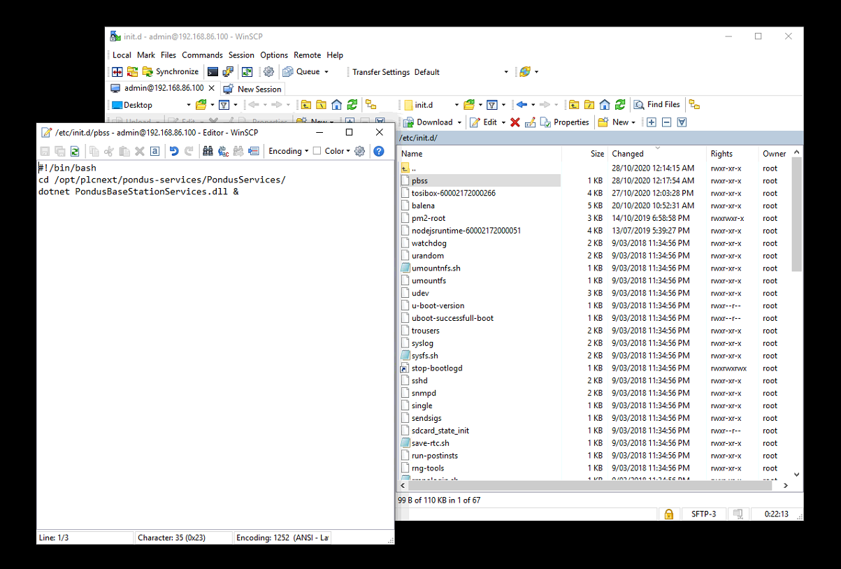

Could you post a sample scripts on how to run a .net core program on startup? or could you provide the step by step procedure? I was able to run a .net core program on it by installing the .net runtime but what I need now is to run the program every bootup or startup of the PLC automatically. I have tried some solutions in google but nothing work like: - Creating sh file in /etc/init.d/ or /etc/rc5.d. -Creating cronjob My sh file contain: #!/bin/bash cd /opt/plcnext/pondus-services/PondusBaseStationV2/ dotnet PondusBaseStation.dll but nothing works for me.

Hi Oliver, Thanks for the reply. I have added & on the end if my script and create it on **/etc/init.d/

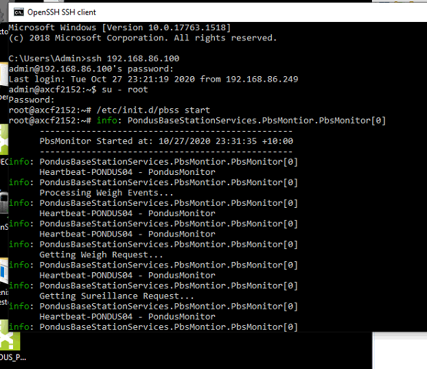

program runs ok when I execute this : /etc/init.d/pbss start
but still it doesn’t execute in startup.

“dotnet some.dll &> /var/log/dotnetPbss.log &”
Then you will at least know whats going on with the dotnet.
You can also add additional echos to your script to see where it might fail.
And have a look at “/var/log/*” for details what is going on at your system startup.

Hi Oliver, Thanks, It works now. The key is the logging you have taught, I was able to see why my program is not running. There are also some configs that I adjust on my program for it to work but now I can confirm that it was executing on startup. Many Thanks!
