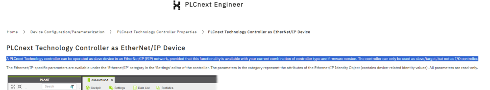

As I know, PLCNext controller can operate as slave Ethernet/IP device not Master.
изображение.pnghttps://engineer.plcnext.help/2024.0_LTS_en/_index.htm?iframe=https://engineer.plcnext.help/2024.0_LTS_en/EtherNetIPDevice.htm

I agree with Olexandr’s answer, currently only the Ethernet/IP-Slave functionality will be supported by PLCnext Runtime/PLCnextEngineer. Please find the additinal information under following links:
System variables - EtherNetIP (plcnext.help)Overview to the Web-based Management on PLCnext Control | Getting started with PLCnext Engineer (youtube.com)
If you need the Ethernet IP master functionality, the solution can be to use our PLCnext controler with Codesys runtime:
PLCnext Store | CODESYS Control for PLCnext SLPLCnext Store | CODESYS libraries
