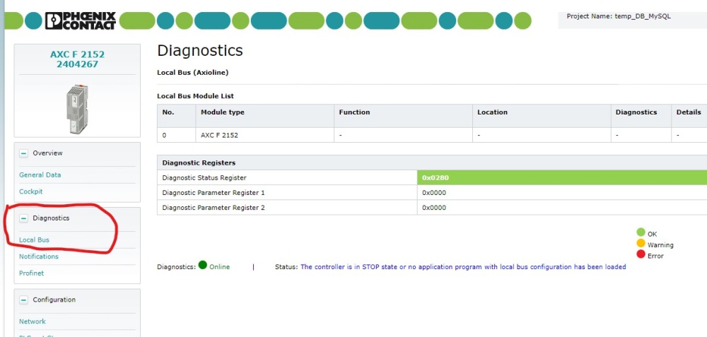

If you go to the WBM for the AXL 2152, there is a page that shows the state of your local bus (see screenshot). Do you have any diagnostics that may indicate an error?

Hi Steve, thank you for your comment. yes indeed the AXL SE analog modules doesn’t work. I also have installed a AXL SE Digital module which works fine. I have an AXL F BP SE4, all leds flashing green, and the up lights is green. On the AXC F 2152, LED BF-D is flashing red. I have included a screenshot of diagnostics. I didn’t think I had a error, but I haven’t been working with the plcnext for very long.

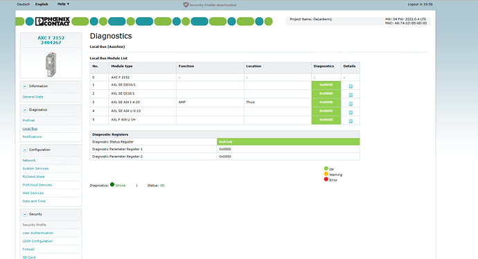

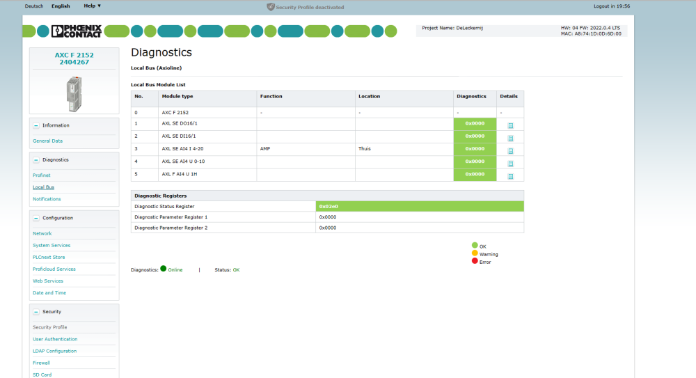

Hello! I have a similar problem. I have an AXC F 2152 PLC with three AXL F BP SE6 module carriers connected to it. After loading the project, the module LEDs on the AXL F BP SE6 units start flashing. Seventeen AXL SE DO16/1 modules and one AXL SE DI16/1 module are connected to the AXL F BP SE6 carriers. If I remove any single AXL F BP SE6 unit, all the others start working normally.
