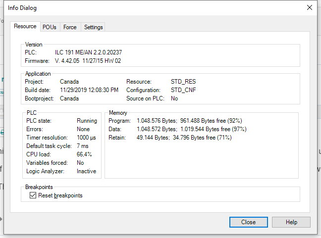

Hi When you compile the program for the PLC, it will make a fault if the program is to big for the PLC. In the error list, it will show how big the program is. If you are online on the PLC you can see the capacity and usage of memory. Project Control Dialog - INFO: You can also go to Project menu, POU/Instance Statics, and see more detailed information about the program and limits. - Emil
Hi manhkuong, I guess you’re talking about PC Worx 6?! Well, even when this forum is more related to PLCnext Technology and PLCnext Engineer I’ll try to help you out here. In PC Worx 6 you’ll after every build in the message window a summary of the used variables, available and used memory and retain.
In case you’re using more than specified for the device you’ll get a build error and you can not download the project to the PLC. Using PLCnext Engineer (for PLCnext Controls like AXC F 2152) you’ll find those information in the control view (statistic tap). Cu Frank
