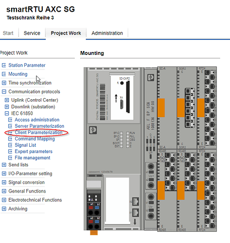

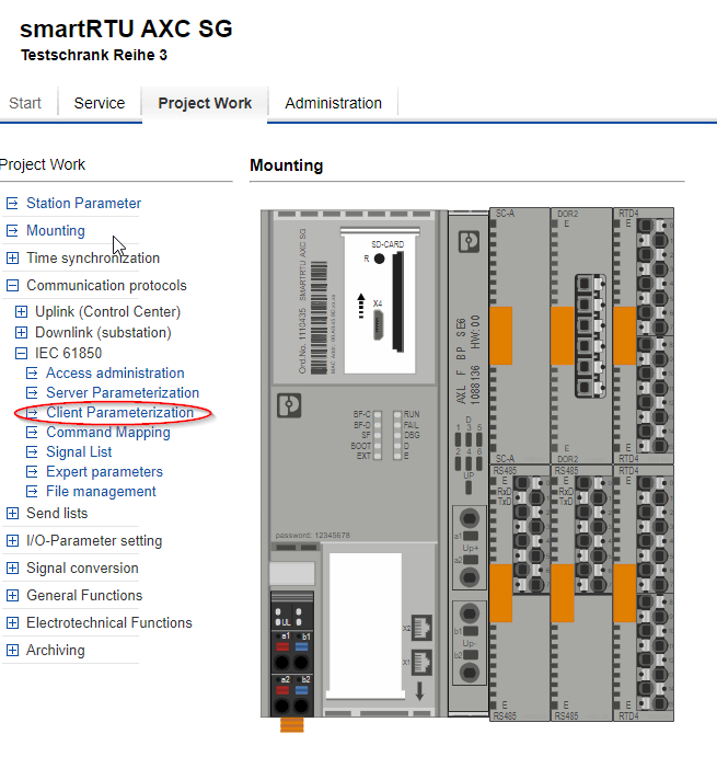

Hello ,
the IEC61850 client function is available in the SMARTRTU AXC SG from FW V01.09.00.02. Please update your device to this version. Than it will look like this:
Link: https://www.phoenixcontact.com/de-de/produkte/fernwirkgeraet-smartrtu-axc-sg-1110435
Regards
Hello ,</p>the IEC61850 client function is available in the SMARTRTU AXC SG from FW V01.09.00.02. Please update your device to this version. Than it will look like this:</p>[https://forum.plcnext-community.net/uploads/A9CCSM46OLSP/image.png</a></p>Link: [https://www.phoenixcontact.com/de-de/produkte/fernwirkgeraet-smartrtu-axc-sg-1110435</a></p>Regards</p>
