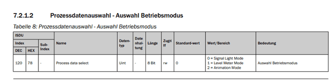

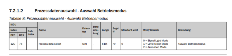

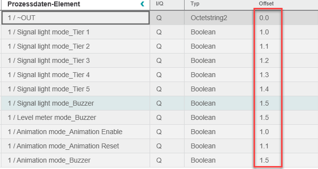

Hello Peter, please find the answers to your questions below: 1) Currently the PnE does not support the parameterization of the individual device parameters of an IO Link device. This means that the module would have to be parameterized externally. Another option is to read / write the IOL indexes of the device via PnE and the acyclic PDI FB for the local bus. In this case for the operating mode index hex78 (see IOLink_Prozessdata.PNG). 2) The IODD also uses a condition attribute which is not supported in the PnE or the IODD compiler does not evaluate this and thus duplicate PD data is available and this leads to problems. The test cannot be carried out because the hardware is not available. Here I would not use the individual bits, but rather the Octectstring2 and set the corresponding bits for the set operating mode (see IOLink_ProzessdataElement.PNG). 3.) The IODD import and the configuration of the device parameters are currently under development, but it cannot be said when this feature will be available. I hope this information help you. Best Regards Eduard
