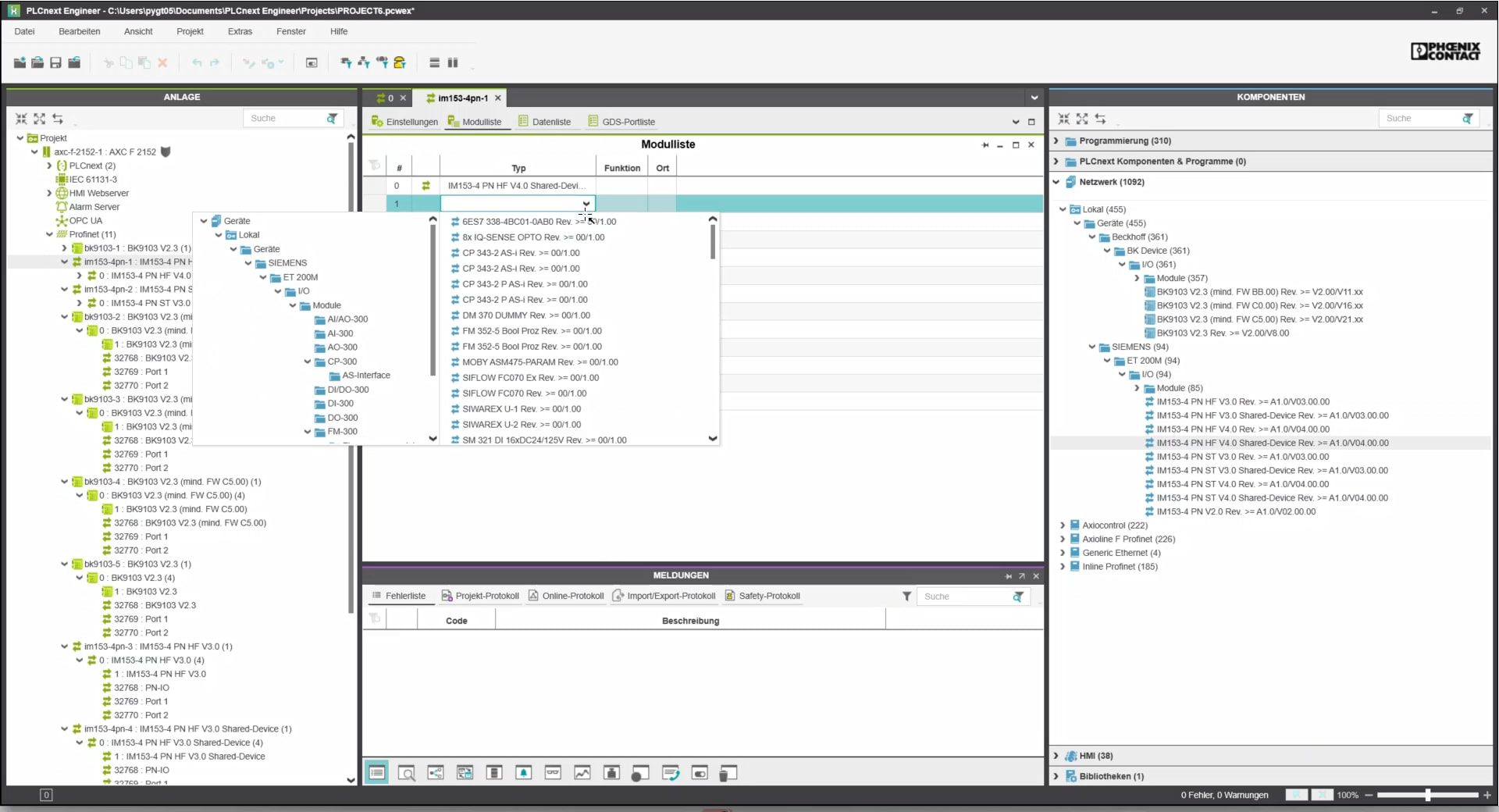

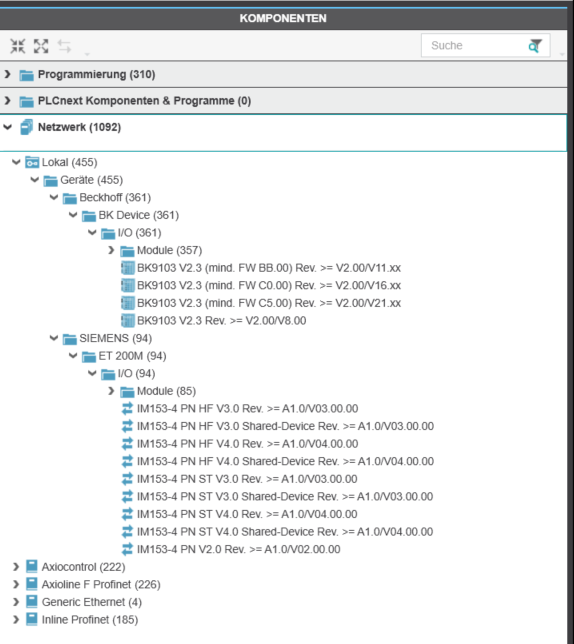

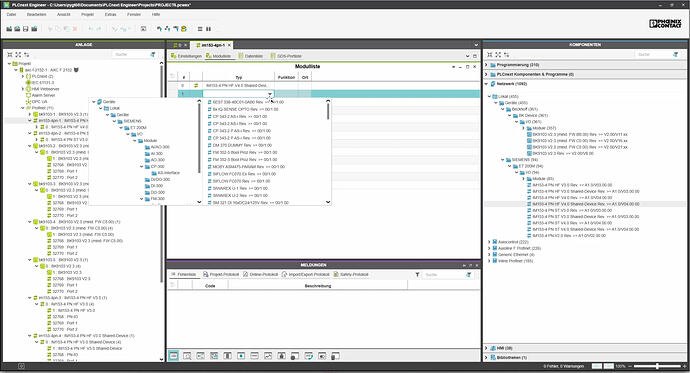

Hello Thomas,
thank You for testing.
It’s correct - I can use the modules; but: the import records an error:
“Fehler”;“13.04.2026 07:09:49”;“MSG_NET0036”;“Fehler beim Import des Geräts BK9103 V2.0. Fehlendes Schnittstellen-Submodul. (D:\SuS_5\Profinet\Hilscher\Gerätebeschreibung\Beckhoff\GSDML-V2.3-beckhoff-BK9103-20240116.xml)”.
So, for the moment, everything works for me, but one of the modules is missing:
“Information”;“13.04.2026 07:09:50”;“MSG_NET0034”;“4 von 5 Geräten erfolgreich aus Datei D:\SuS_5\Profinet\Hilscher\Gerätebeschreibung\Beckhoff\GSDML-V2.3-beckhoff-BK9103-20240116.xml importiert.”
Of course, as long as everything works, I can do my work; also “warnings” and “hints” may be acceptable, but “error” takes me a little bit nervous.
