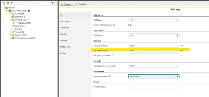

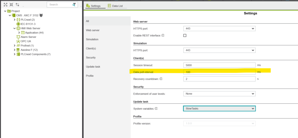

Try lowering this value. I am currently running at 100ms in the lab and it seem to work quite well (on laptops as hmi clients, not using hmi panels as most are too slow)
