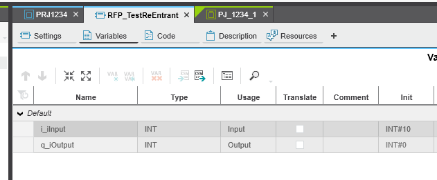

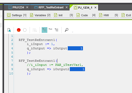

A test FB is init as follows:

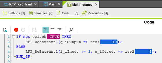

The code is
this is the debug result
As you can see is that at the 2nd call the i_iInput value still has the value of the first call and is not initialised with the default value 10.

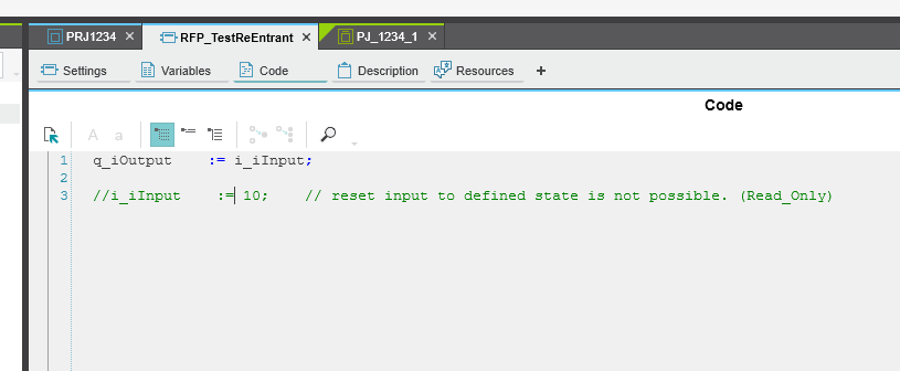

It is also not possible to initialise the input variable to a known value when leaving the FB.

You use the same fb instance in calls, and it has already initialize input variable with “1” on line 3. Why it should reinitialise with 10 in the next call? Even if you comment substitution of input value on line 8, in the memory area of RFP_TestReEntrant_1() it has already defined as “1” because of substitution on line 3. It will be mach more surprise if the same instance call with the same input parameters return different result.
You have to create new instance RFP_TestReEntrant_2() to deal with it’s initial (default) inputs values.
Actually input variable does not have to be changed at the moment of return from fb internal scope. It is not dedicated for this (It provide variable by value, for internal scope of fb usage). You have to use InOut variable usage type, if you want to change “input” (provide variable by reference) for changes in outer scope of program.

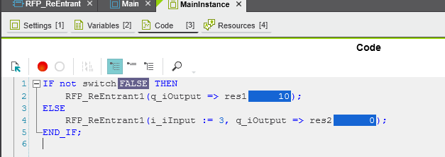

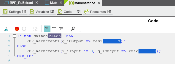

Try to rewrite code in the next manner, for more clearity
1. According to IF conditions, call fb on line 2. It implicitly set i_iInput with initial value 10 and transfer it to output.
2. Now we call fb with input value explicitly set, and have new return value of output. This explicit value 3 stored in internal memory of fb.
3.Now we go back to implicit branch, but it return updated output value according to fb internal stored data.

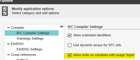

Hi Marco,
you can write the inputs at the end before leaving the FB.
There is an option to enable it
or maybe it isn’t that simple and I did not understand the problem.
Cheers
DivisionByZero
Hi DivisionByZero
Normally ‘division by zero’ gives a lot of problems.. In this case it solves my problem :wink:
thanks.. I was not be aware of this option.

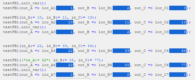

Ok, in this case, you should be more strict when instruct the plc)
it seems that adding of init method to the FB can be good idea.
In this case it is possible to return internal state of fb to certain predefined point. At the moment it is necessary.
