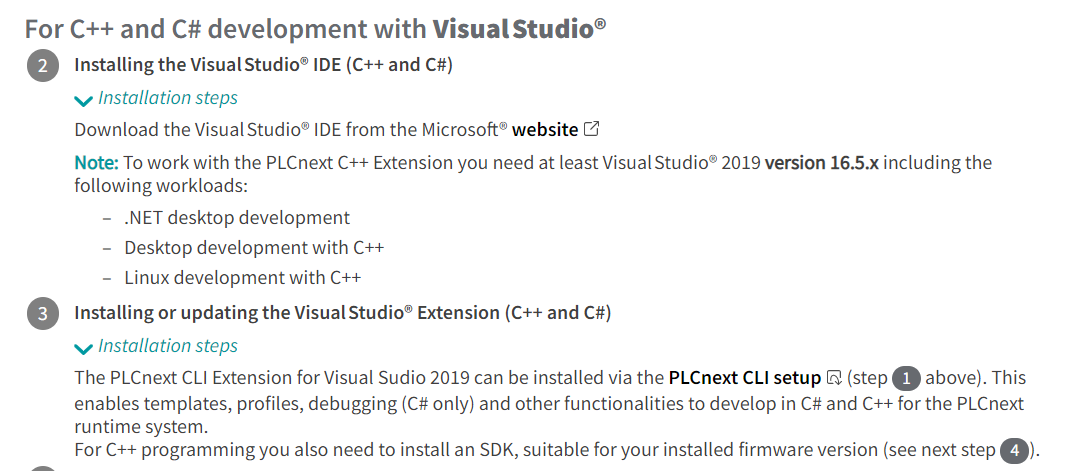

How can I get the remote dubugger installed?I don’t think that’s part of the Toolchain installation. Have you installed the VS workloads mentioned below?
