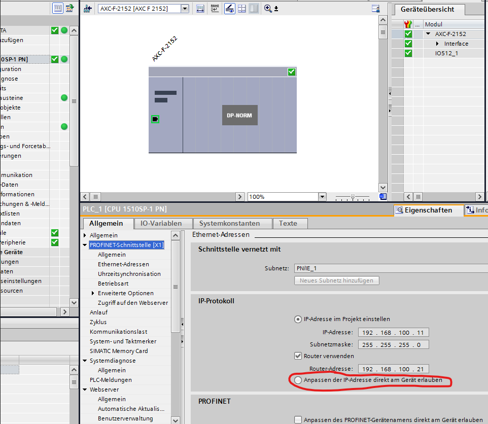

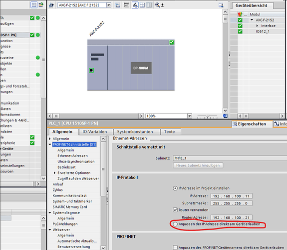

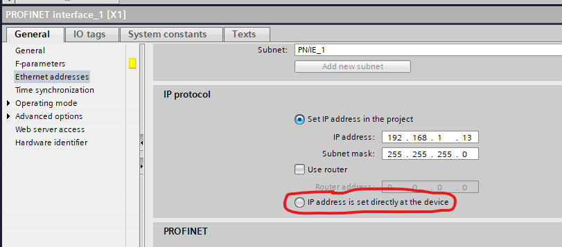

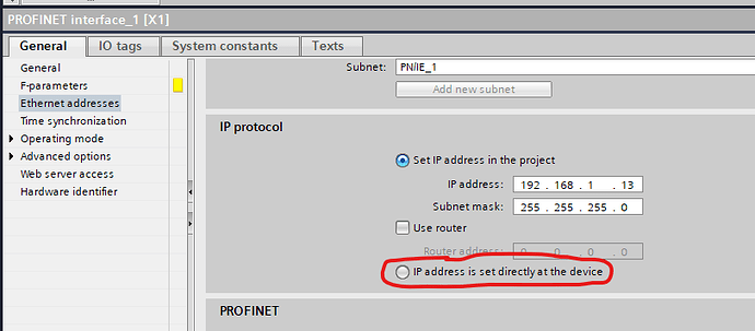

Robo7795, If you want to set the network parameters on the device, you need to make sure you choose “IP address is set directly at the device” in TIA Portal, otherwise, as Frank says, the settings will be overwritten as soon as the Siemens CPU is connected. Keep in mind that if you do this, you need to make sure both the IP address and the PROFINET name are configured exactly the same in PLCnext Engineer and TIA Portal, otherwise the Siemens CPU won’t “see” the PLCnext CPU as being the correct device. John
