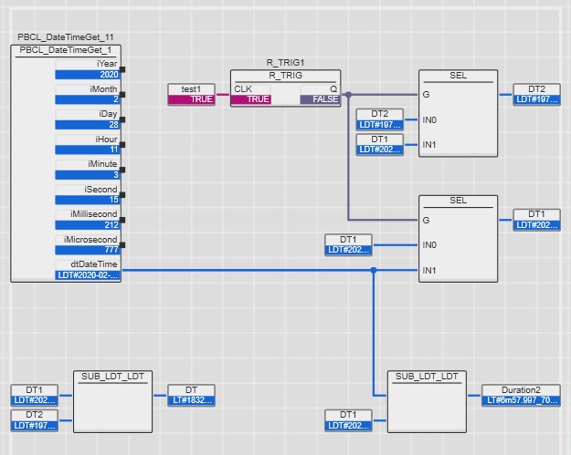

I have to use the DateTimeGet function block to count the time. It has a LDT data format output that can be used for calculation.
I attached the time counter logic in the attached file. The variable “Duration2” displays the counting time.
