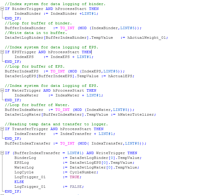

I have had an issue that comes close. Needed to log data at fixed intervals that have been triggered by the controlled process. A standard logger would not do because the data are coming at different times but still need to be collected in to on record. I have added a loop function so that I record 5 data sets and transfer those to Visu+ before starting to overwrite the record in the PLC again. That way I limit the size of my ARRAY, but still have a complete production raport. Therefore I have created a STRUCT where I write my data when triggered. After all data are collected, I write the data to a data logger in Visu+ and later in to an production raport. But instead you can write the data in to a CSV file. You would need a STRUCT for your PID variables and an ARRAY of the STRUCT to save them in. Add an index and time stemp and you have a record. When you want to go the extra distance, make a HMI page in the eHMI for the technician. There you can have the data shown you want to record and also trigger the write function. Plus, you would be able to look at the past records and compare. Peter Paul
